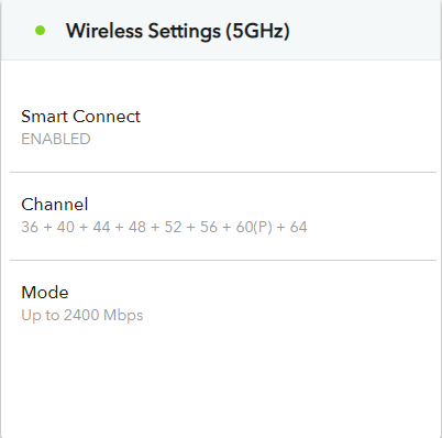

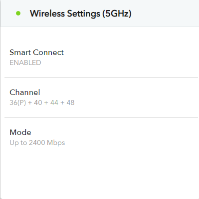

For me is RAX40 really unstable. It connect and disconnect all time with LAN, 5Ghz and 2.4Ghz on Firmware 1.0.3.80.
And I have noticed behavior of 5Ghz. I choose a wifi channel, but the router always go back to channel 36 even if this is the worst channel. I belive it crash, becuse I can see channel numbers av changed in Wireless Settings (5GHz)
