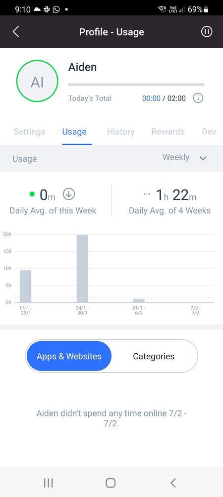

I purchased this router a few months ago, paid for the parental controls system, and had parental controls all working as expected.
A few days ago, I noticed the kids were using the internet more than expected - and having a look at the parental control system, it now looks broken.

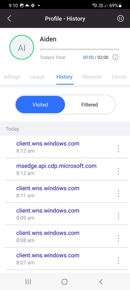

All devices are showing "Zero usage" in Nighthawk for the last week, even though the history tab has correct and ongoing usage. I don't know if this is the reason the parental controls have broken, as even disabling devices doesn't seem to work properly, nor does the nightly cut-off time.
I have since made sure the router and Nighthawk have been updated to the latest, but thats made no difference.
If I can find the original firmware this shipped with, I will try downgrading.
It was working until the start of February, and it hasn't worked since.
