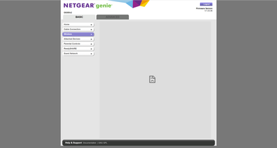

      Thanks for the suggestion.  I logged into routerlogin.net and was able to access the wifi settings for my router.  When I accessed the wifi settings tab, there was a passcode set for both wifi frequencies - however the 2.4 was still showing as unsecure.  I set the 2.4 security option to None and saved it.  Then I went back in and set it to WPA2-PSK [AES] and entered a new passcode.  I used a passcode with all lowercase letters, no numbers.  I also tried a different passcode with lowercase letters and number.  Neither try worked and the 2.4 is still unsecured.  Also, each time I click the Apply button to save my changes, it results in this screen:
      Not sure what I can try next.
      Thanks again for replying to my questions 🙂

        what is telling you its unsecure?
