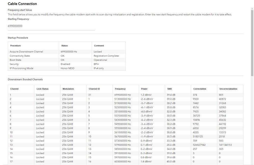

i'm having terrible packetloss on ALL devices. restarted modem, factory reset modem and still nothing. has been like that for a week. isp was useless saying it is my fault but the modem is ok.

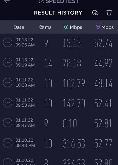

I unplugged everything from the modem besides my computer and nothing changed. My speed tests should be gigabit but are abominable even though actually downloading stuff seems fine.

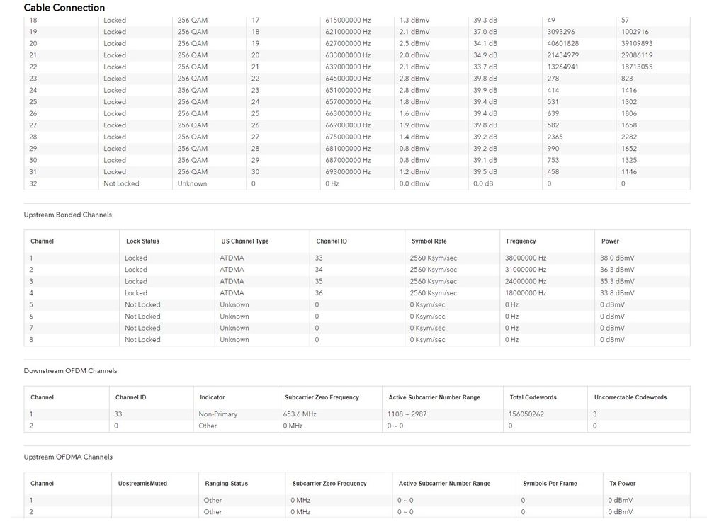

      Your power levels are out of spec and you have a ton of errors.
      Remove any splitters, amplifiers, or signal attenuators from your line.
      Check your line for cheap cables, extended runs, bad/old/cheap/corroded ends and replace them.
      Preferrably move the CAX to right where the coax comes into the home and direct connect there.
      If that doesn't help, the ISp will need to check the line

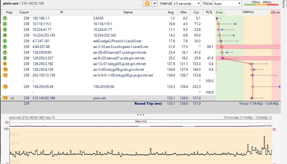

    Don't know the relation between a traceroute to an overseas site, and where you suspect terrible packet loss. Here an ad-hoc check originating from Switzerland  - where two hops seem to add latency (from Paris to Virginia US, addign about 80 ms total ~100 ms) and then through the US (from Virginia to LA, adding about 50 ms, total  ~150 ms) and last but not least from California to Japan (LA to Tokyo, plus 100 ms or more, total ~250 ms):
    9 8 ms 8 ms 8 ms i00mil-015-ae0x40.bb.ip-plus.net [138.187.130.31]
    10 9 ms 9 ms 9 ms 193.134.95.251
    11 9 ms 10 ms 9 ms ae-1.r20.mlanit02.it.bb.gin.ntt.net [129.250.3.84]
    12 19 ms 22 ms 19 ms ae-10.r21.parsfr04.fr.bb.gin.ntt.net [129.250.4.188]
    13 97 ms 100 ms 98 ms ae-13.r24.asbnva02.us.bb.gin.ntt.net [129.250.6.6] <<< F <-> VA, +80 ms
    14 97 ms 96 ms 96 ms ae-0.r25.asbnva02.us.bb.gin.ntt.net [129.250.2.36]
    15 149 ms 149 ms * ae-2.r25.lsanca07.us.bb.gin.ntt.net [129.250.3.189] <<< VA <-> CA, + 50 ms
    16 263 ms 280 ms 260 ms ae-12.r31.tokyjp05.jp.bb.gin.ntt.net [129.250.3.192] <<< CA <-> JP, +100 ms or more
    17 249 ms 248 ms 249 ms ae-3.r00.tokyjp08.jp.bb.gin.ntt.net [129.250.6.129]
    18 250 ms 249 ms 249 ms ce-0-8-0-1.r00.tokyjp08.jp.ce.gin.ntt.net [203.105.72.158]
    19 * * * ...
    20 251 ms 252 ms 251 ms 158.205.95.54
    21 * * * ...
    22 252 ms 251 ms 252 ms 210.140.92.180
    Friendly reminder: ISP and carrirer backhaul routers have more important jobs to do than handle IGMP.
    Probably Gigabit on the downstream, indeed one could expect higher numbers.
    The amount of correctable, and much more the uncorrectables on the RF link (the cable modem part) are just ridiculous.
