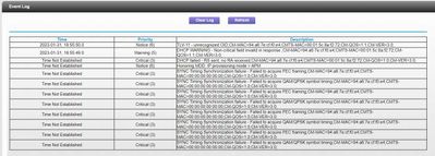

event log.
3 Replies
- plemansGuru - Experienced User
Sadly thats just the standard bootup log. It clears on reboot for most devices.

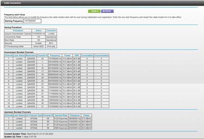

Do you have a screensnip of the cable connections page?
Wow your signal is coming in hot. It should be between -7.5dbmv and 7.5dbmv. You're over 15.
You need a signal attenuator in line. That hot of a line would cause reboots easily.
