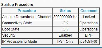

C7000 stuck in IPv4 Only Mode on Charter
I recently moved with my C7000 modem/router combo that I've had for a couple years.  Previously I was using it on Comcast/XFINITY with no problems at all - everything worked great.
Now I live in a region with Charter Spectrum, who also says that this device is supported and should work fine.  However, the modem is currently stuck in IPv4 Only mode in the IP Provisioning mode.
I believe that this is the reason that I am having difficulty accessing many sites, with many of them either not loading at all or loading very slowly.  This includes sites like Google Drive (and all other Google sites) and Twitter.
Firmware is currently version 1.01.32.

    • oncourse's avatar
      oncourse
      Attached screenshot of provisioning mode issue.
      If I run a test at testmyipv6.com, it shows I do not have ipv6.  If I attempt to load the ipv6 only test, the page will not load.
      In the ipv6 settings it shows the system delegated prefix and that's it, no other info.
      • plemans's avatar
        plemans
        My inlaws have the same C7000 on charter. I remoted in quick and their's shows the same IPv4 Only when you click on the modem. I've got it setup through their Advanced----advanced setup----IPv6 in auto config mode. And it pulls the proper setup but still shows "Ipv4 only" on modem page. Running it through the ipv6 test it gets 9/10 with only charter's dns server failing.

      • vkdelta's avatar
        vkdelta
        NETGEAR Employee Retired
        there are two IP stacks on the device and they are independent of each other.
        The screenshot which refers to Ipv4only provisioning means Charter has provisioned your Cable modem to IPv4 ONLY. They have intentionally done it from their provisioning systems. this is for CM Mgmt
        For eRouter/WAN, there is WAN stack where user traffic is routed. You need to show Advanced page tab and also WAN connection and IPv6 connection page info.
        C7000 device just get told to provision WAN on IPv4-only or Dual-stack. Charter's DHCP/DHCPv6 and config file needs to enable dual-stack. If they have not done that, you will not see dual-stack.
