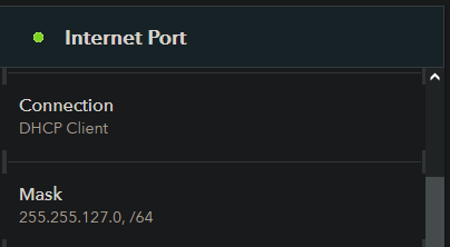

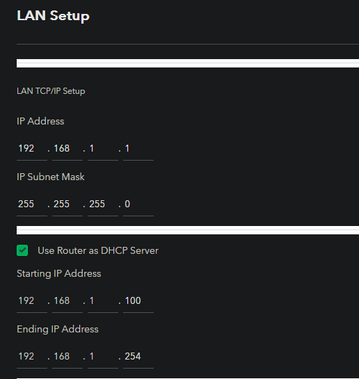

    • plzhelprouter's avatar
      plzhelprouter
      Latest Firmware V5.1.1.8. Did all you said (multiple times even) and still doesn't save settings upon reboot and have to renter all info again (as per usual thus far).
      Have tried via Firefox, Brave, and Chrome - all w/ the same result - settings dont save have to manually resetup eveything.
      Is this a normal subnetmask for Internet connection tab???
      In the LAN section this is my subnet
      Why wont this router save settings??

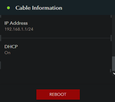

        plzhelprouter
        Dont know if this is relevant but cable information via router ipaddress and range
        Cable Information on gatewaystatus via 192.168.1.1
