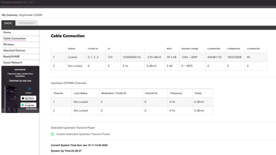

    I have the same issue with firmware v 2.1.3.7 causing reboots. My ISP is xfinity.
    Just want to point out what I noticed. The Current System Time located on Cable Connection tab is defferent for one hour bitween my current local time. But the time is correct on the tab of NTP Settings.
    I'm not sure if this was on previous firmwares and if it affects the reboot issue.

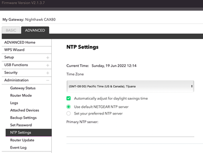

      3)  The time issue is VERY easy to fix:
          - Under Advanced click on Administration > NTP Settings.  Change the GMT time to what covers you.  IF you are not sure, google
            "What GMT am I located in" and it will show you.  THEN click the box next to Automatically Adjust for daylight savings time.  Problem
             should be resolved.  HOPEFULLY Congress will get it's act together and do away with DST once and for all.  This is for another topic
      4) Finally, call support.  Pay for support, we can't get this addressed through the Forums without an official process.
