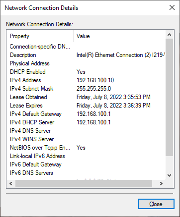

      What does your PC see in this window when connected to the modem with out the router in between?

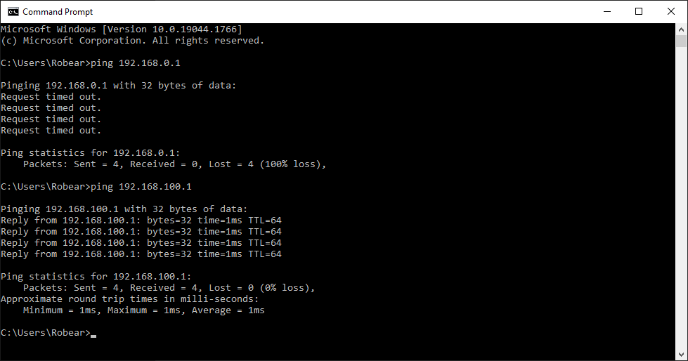

      Can you ping 192.168.100.1 with the PC directly connected to the modem?
