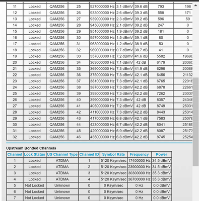

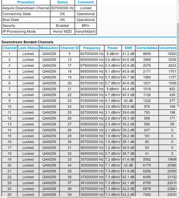

Hi all, I just bought this CM1200 and it was working fine but all of a sudden now after a while the connection drops to like 12mbps we are supposed to have gigablast (COX) service. If we reboot the modem we will get around 900mbps but after a while it goes back to 12mbps. Some more info is I had a motorolla surf modem before this that I had the same issue which I thought was the modem so I bought this CM1200 thinking it would fix the issue

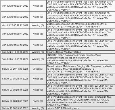

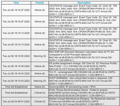

I am not sure if the logs or settings will help but I will post them

Your power levels are border on a bit too high.

Have the ISP check the signal and line quality UP to the modem. Be sure the ISP provisions the modem correctly.
Lots of correct and uncorrectables that should be zero.
