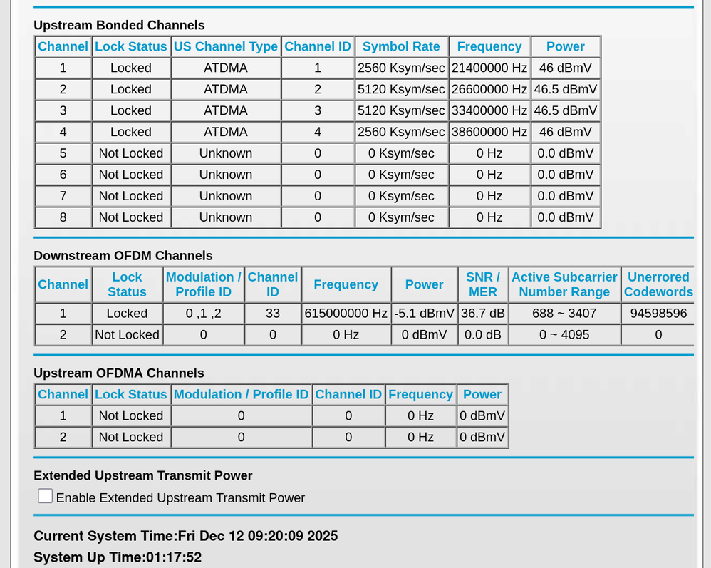

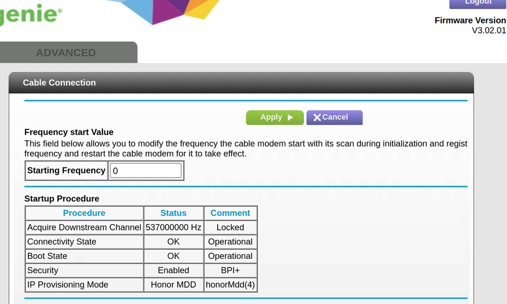

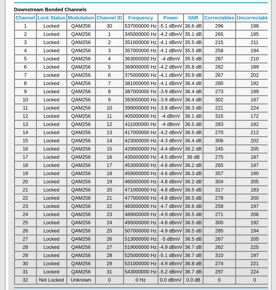

I am suddenly having the same issue. Have to turn the modem off, wait a minute then turn back on. It's good for a bit, then it happens again. Times are totally random that it goes down. All lights showing its working fine. Router (ASUS RT-AX86U Pro (AX5700) shows all is fine. Attaching logs...
Any help would be much appreciated.

    Power levels are on the low side but with in specs:
    https://kb.netgear.com/24311/Power-level-guidelines-for-a-NETGEAR-cable-modem-router
    Lots of correctables and un-correctables that should be mostly zeros.
    Any Criticals, Errors or Warnings seen in the event logs needs to be reviewed and resolved by the ISP. Indicates a signal issue on the ISP line up to the modem.
    Have the ISP check the signal and line quality UP to the modem. Be sure the ISP provisions the modem correctly.
    Be sure there are no coax cable line splitters in the between the modem and ISP service box.
    Be sure your using good quality RG6 coax cable up to the modem.
    Start with removing any amplifiers, signal attenuators, or splitters from the coax.
    From there check the line for kinks, damage, moisture in the line.
    Check the connectors for improperly made ends, foil touching the copper coax line, loose connections, bad/old/cheap connectors, or corroded connections. Replace them if you do.

  • Also here is a PDF of the Modems LOG from this am when I restarted it... I have since cleared the log and 11 new notices and 1 new Critical...
