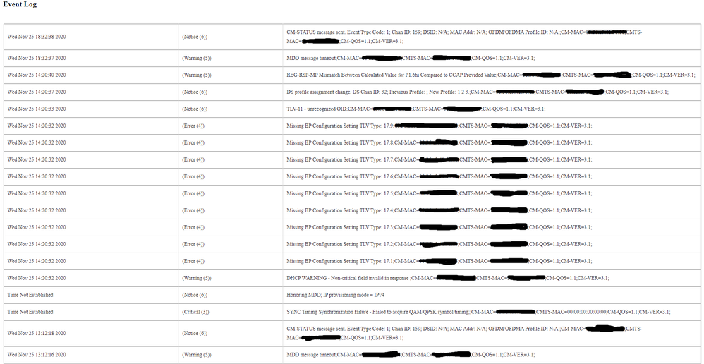

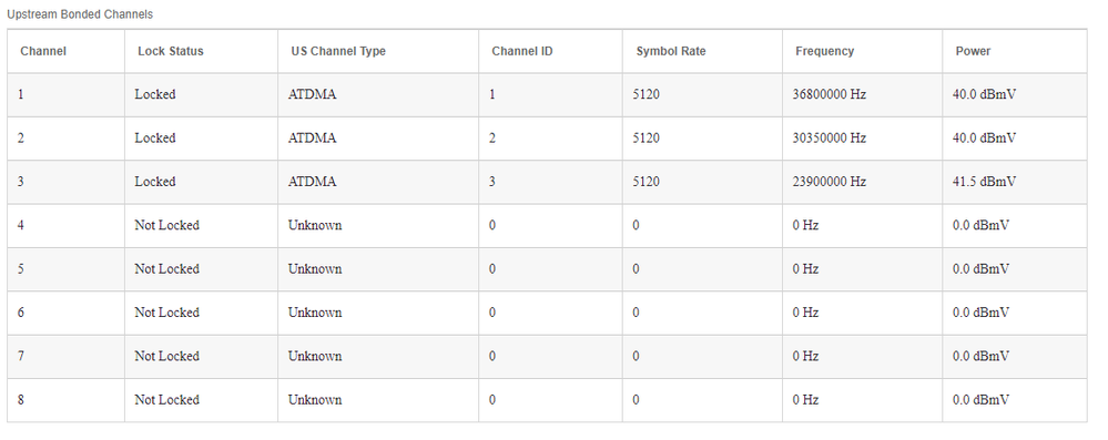

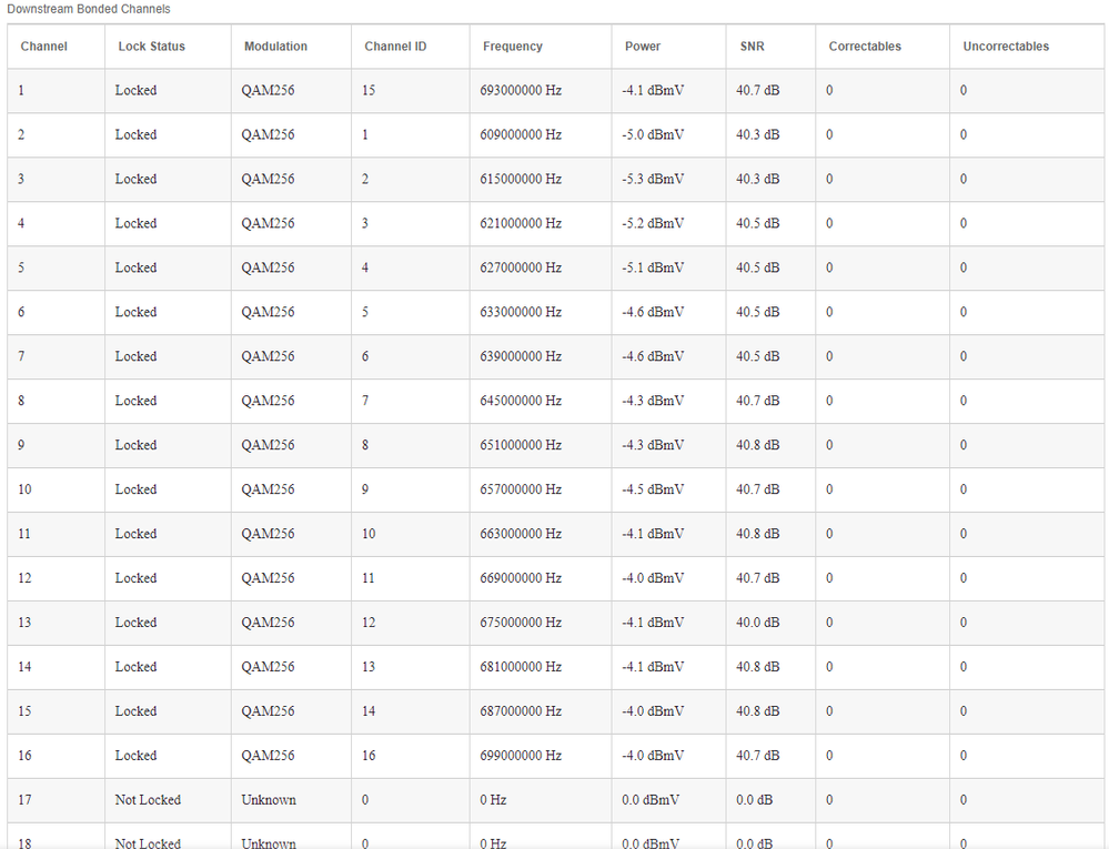

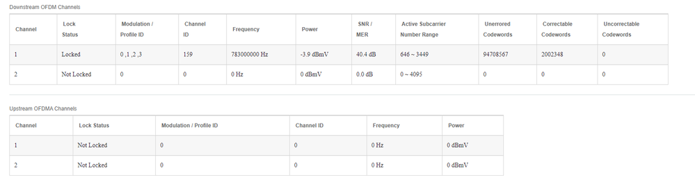

Having a sporadic issue with my new Netgear CM2000 modem. I keep losing the downstream connection, or so it seems, the LED blinks and I have no connectivity. Rebooting the modem fixes the issue. I have a Orbi RBR850 for the router with one satellite. I have attached a picture of the logs for today when it happened and downstream and upstream. I have RCN for internet ~200Mb down 20 up. Any help is appreciated thanks!

      Doesn't look like you have any channels locked after channel 16 on the downstream?
      I'd have your isp check the line. Like FURRYe38 says, check the line for kinks, damage, poor/cheap connectors, loose connectors, extended runs. Preferably, directly connect the coax from where it enters the home to the modem. if there's a splitter, remove it and check the connections.

        Yes. No channels locked after 16 down. I don't have gig service, so I don't think I need them? Current service level is 155 down but I get 200 accross speedtest sites. Will check the splitter locations and for damage thanks.
