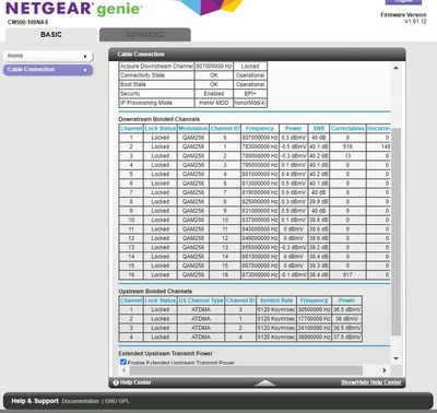

    • FURRYe38's avatar
      Before placing blame or false claims on bad equipment, I'd have the ISP check the coax signal line up to the modem. Though your power is moderately in spec, is kind low. And you have some correct and uncorrectables. They should most be all zeros.
      Some checking on the coax line for good quality coax, splitters and bad jacks can cause problems for ANY modem. Even your next one. So do your self a favor first and make sure and have the ISP make sure the signal up to the modem is of good quality and working well.
      If it's garbage IN, you'll get garbage out on ANY Modem.
      I've had several NG modems and all have worked well. Even a CM700.
      Do a bit more checking on the ISP side and cabling before claiming it's a equipment problem. Otherwise, even your next purchase may see problems as well.
      Good Luck.
