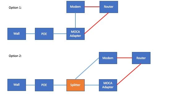

      Sorry; I have xfinity coming in via coax. I have my cm600 modem on one floor. It's connected to an Airport router / wifi access point. I want to use the coax in the house to transmit internet instead of using the wifi. So I am thinking of getting a pair of Actiontec MOCA adapters to do that. I'm just not sure of the wiring. I've seen two configurations: one without a splitter and one with. I'm trying to dicern which to use. Blue lines are coax; red are ethernet.

           "transmit internet" to what?  Neither of your two configurations
        makes any sense to me.  Why would there be a closed loop of any kind?
        What's a "POE"?  Where does Xfinity appear?

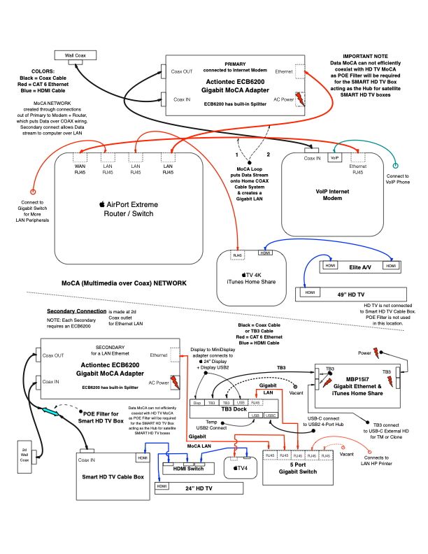

    While I've got a different modem / router setup, I am using a pair of Actiontec's ECB6200 Adapter (for a MoCA LAN), and my setup has been in use reliably for 2 years.
    I'm providing a jpeg (converted from a PDF I created), which details the full setup, but shows you the initial cabling between Coax wall outlet, Modem (which in this case was an Arris - Comcast - VoIP modem), & my  AirPort Extreme router / switch.
    So, just think in terms of substituting your hardware in the cabling setup, & you'll get yours easily completed. (Unless interested, you can ignore a lot of the other connections involved in my MoCA LAN.) ...Let me know of any follow-up questions; I'll be happy to clarify.
