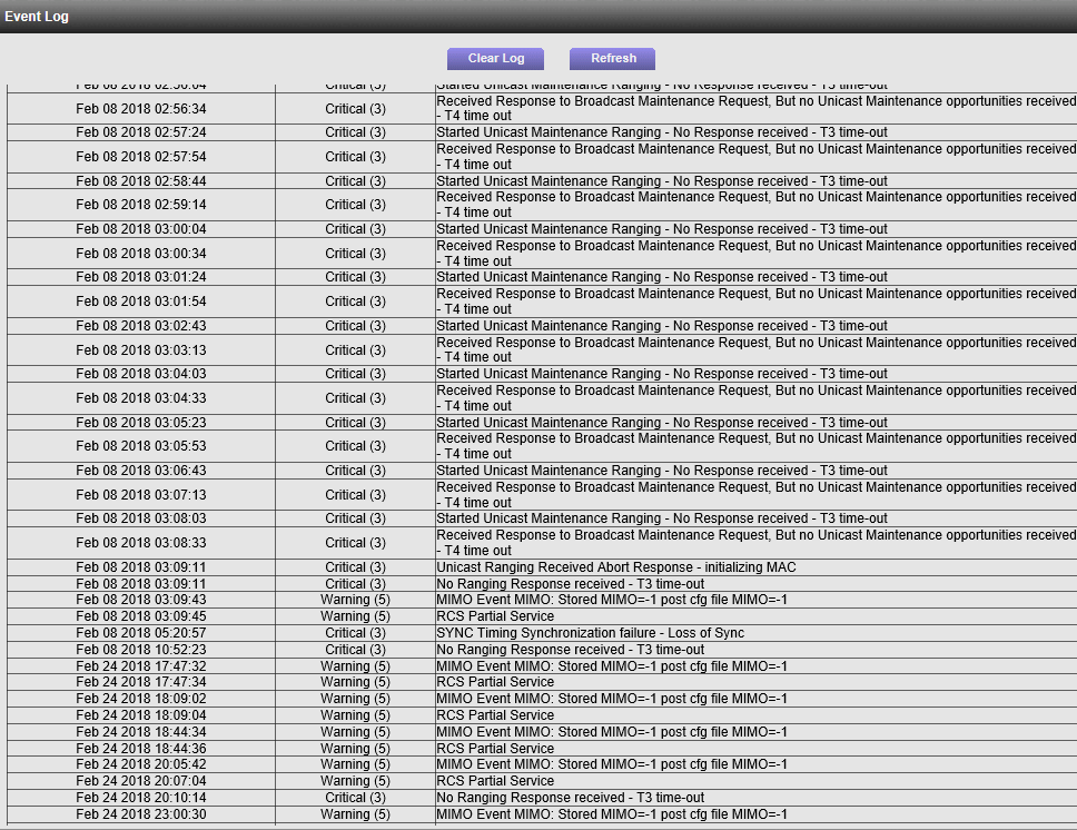

few months old CM700 - pay for 150Mbps .... noticed slower speeds recently.  getting 30Mbps, even when PC connected directly to modem. Have done all the usual resets, etc.
Checked the firmware on the modem against the lastest posted by Netgear, and it looks like they are the same.  WHAT IS WEIRD is that teh firmware page on Netgear.com was updated on 2/8/18, leading me to possibly believe that is when the newer firmware came out. The coincidental part is that if you look at my logs (which actually only go back to 2/8), that's when the T4 and T3 critical errors started.  Any idea what might be going on here, other than having the tech check the outside lines?

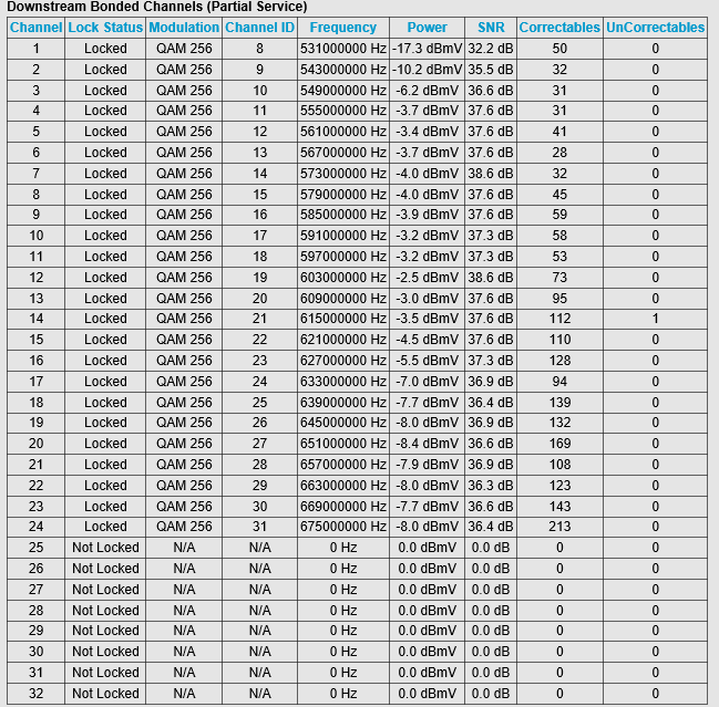

    Please post the power values from the connection page.
