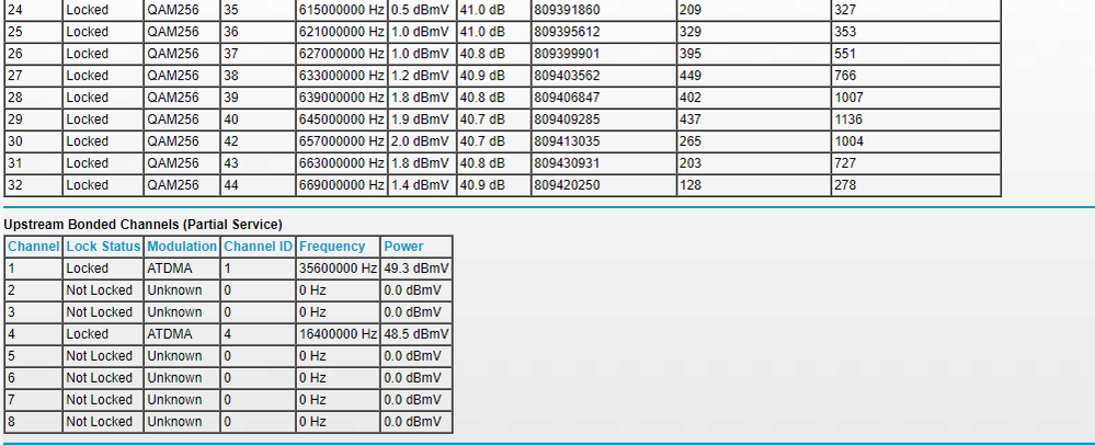

The picture below is when a notice that it is in the process of losing its upload channel bonds where the modem is trying to re-lock or it can lose all the download channel bonds.

      Well it did it again 2 times so far. Here is a list of the download and upload channels

        Your upstream levels are high meaning the router is having to increase its output power just to communicate with the cmts. You also have range window violations which are power levels that are going outside of parameters.
