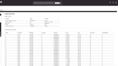

    Please post a copy and paste of the modems connection status page.

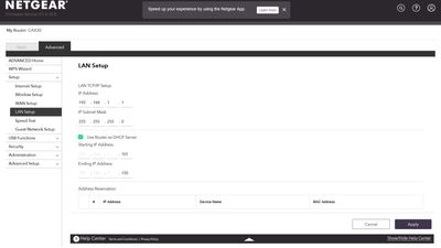

    Have you tried seeing the default IP address pool to 192.168.1.100 to .200?
    Static IP addresses should be set outside a default IP address pool, not inside it per standard networking methods.

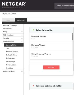

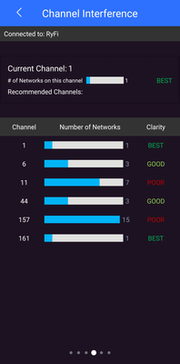

      I have attached multiple screenshots to provide references to the information you requested from me, with the exception of the CAX30 wireless settings information page. Modem connection status all appears normal. I already have the router DHCP address pool set at 192.168.1.100 - 192.168.1.150 (I reduced the IP address pool to end at .150 instead of .200 because I found 100 IP addresses an unnecessarily large amount for our needs). Regarding the wireless settings, the 2.4G channel is set to Auto, although I actually have the 2.4 wireless radio disabled due to interference and signal drops it was causing with my Xbox headset's USB wireless transmitter that also operates on the 2.4Ghz band. My 5Ghz channel is set to 161, at the recommendation of a Netgear support agent I had spoken to a few months ago when I first experienced these wireless connectivity issues. To answer your question about WiFi neighbors.. I live in an apartment complex with many neighboring WiFi signals in my building, as you can clearly see in the very last screenshot taken from the Nighthawk mobile app on my phone. Hopefully all this info helps and feel free to let me know if there's anything else I can provide that could help with this troubleshooting. Thanks for your help!
      Modem Page 1
      Modem Page 2
      CAX30 Device Information
       LAN Page / Router DHCP
      Neighboring WiFi Channel Statistics

    SO your getting some correctables. Means the modem is taking care of data ok. Usually those would be all zeros. Something you might look into with the ISP. Sometimes those can be solved by checking cabling, connections and no splitters on the line.
    If you live in a apt complex, reduce the transmit power on both radios from 100% to try 50% first...maybe 25% if your in a small sized apt area. This will help with interferences from neighboring wifi signals.
