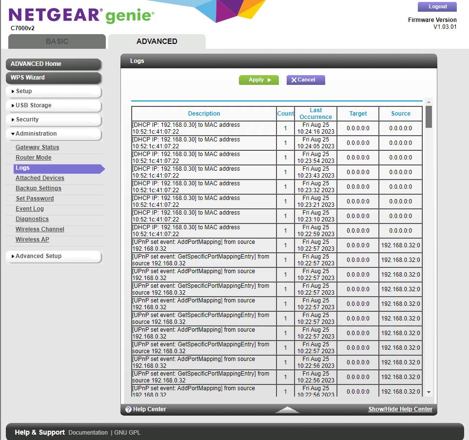

I have had this C7000v2 for a couple years with no problems but the last two months it looses internet multiple times a day, when it goes down it is for about 3 mins then it comes back. The lights on the router stop blinking. below is the log that shows date and time of each time we loose internet.

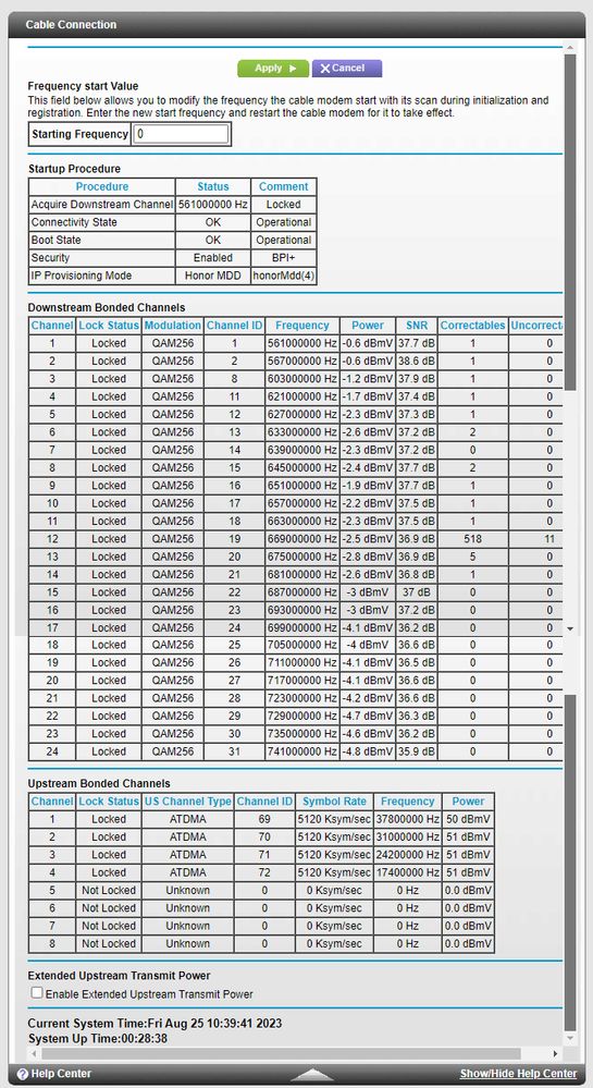

Please post a copy and paste of the modems connection status and event log page.
https://kb.netgear.com/30007/How-do-I-obtain-the-cable-connection-information-from-a-NETGEAR-cable-modem-modem-router
https://kb.netgear.com/30008/How-do-I-view-or-clear-the-event-logs-on-my-NETGEAR-cable-modem-or-modem-routerOK here is connection report:
Frequency start Value This field below allows you to modify the frequency the cable modem start with its scan during initialization and registration. Enter the new start frequency and restart the cable modem for it to take effect. Starting Frequency Startup Procedure
Procedure Status Comment Acquire Downstream Channel 561000000 Hz Locked Connectivity State OK Operational Boot State OK Operational Security Enabled BPI+ IP Provisioning Mode Honor MDD honorMdd(4) Downstream Bonded Channels
Channel Lock Status Modulation Channel ID Frequency Power SNR Correctables Uncorrectables 1 Locked QAM256 1 561000000 Hz -0.6 dBmV 37.7 dB 1 0 2 Locked QAM256 2 567000000 Hz -0.6 dBmV 38.6 dB 1 0 3 Locked QAM256 8 603000000 Hz -1.2 dBmV 37.9 dB 1 0 4 Locked QAM256 11 621000000 Hz -1.7 dBmV 37.4 dB 1 0 5 Locked QAM256 12 627000000 Hz -2.3 dBmV 37.3 dB 1 0 6 Locked QAM256 13 633000000 Hz -2.6 dBmV 37.2 dB 2 0 7 Locked QAM256 14 639000000 Hz -2.3 dBmV 37.2 dB 0 0 8 Locked QAM256 15 645000000 Hz -2.4 dBmV 37.7 dB 2 0 9 Locked QAM256 16 651000000 Hz -1.9 dBmV 37.7 dB 1 0 10 Locked QAM256 17 657000000 Hz -2.2 dBmV 37.5 dB 1 0 11 Locked QAM256 18 663000000 Hz -2.3 dBmV 37.5 dB 1 0 12 Locked QAM256 19 669000000 Hz -2.5 dBmV 36.9 dB 518 11 13 Locked QAM256 20 675000000 Hz -2.8 dBmV 36.9 dB 5 0 14 Locked QAM256 21 681000000 Hz -2.6 dBmV 36.8 dB 1 0 15 Locked QAM256 22 687000000 Hz -3 dBmV 37 dB 0 0 16 Locked QAM256 23 693000000 Hz -3 dBmV 37.2 dB 0 0 17 Locked QAM256 24 699000000 Hz -4.1 dBmV 36.2 dB 0 0 18 Locked QAM256 25 705000000 Hz -4 dBmV 36.6 dB 0 0 19 Locked QAM256 26 711000000 Hz -4.1 dBmV 36.5 dB 0 0 20 Locked QAM256 27 717000000 Hz -4.1 dBmV 36.6 dB 0 0 21 Locked QAM256 28 723000000 Hz -4.2 dBmV 36.6 dB 0 0 22 Locked QAM256 29 729000000 Hz -4.7 dBmV 36.3 dB 0 0 23 Locked QAM256 30 735000000 Hz -4.6 dBmV 36.2 dB 0 0 24 Locked QAM256 31 741000000 Hz -4.8 dBmV 35.9 dB 0 0 Upstream Bonded Channels
Channel Lock Status US Channel Type Channel ID Symbol Rate Frequency Power 1 Locked ATDMA 69 5120 Ksym/sec 37800000 Hz 50 dBmV 2 Locked ATDMA 70 5120 Ksym/sec 31000000 Hz 51 dBmV 3 Locked ATDMA 71 5120 Ksym/sec 24200000 Hz 51 dBmV 4 Locked ATDMA 72 5120 Ksym/sec 17400000 Hz 51 dBmV 5 Not Locked Unknown 0 0 Ksym/sec 0 Hz 0.0 dBmV 6 Not Locked Unknown 0 0 Ksym/sec 0 Hz 0.0 dBmV 7 Not Locked Unknown 0 0 Ksym/sec 0 Hz 0.0 dBmV 8 Not Locked Unknown 0 0 Ksym/sec 0 Hz 0.0 dBmV Extended Upstream Transmit PowerEnable Extended Upstream Transmit Power
Current System Time:Fri Aug 25 10:39:41 2023System Up Time:00:28:38
here is the event log:
Time Priority Description 2023-8-25, 10:12:47 Warning (5) MDD message timeout;CM-MAC=9c:c9:eb:c9:0f:88;CMTS-MAC=00:01:5c:b4:e6:87;CM-QOS=1.1;CM-VER=3.0; 2023-8-25, 10:12:19 Notice (6) TLV-11 - unrecognized OID;CM-MAC=9c:c9:eb:c9:0f:88;CMTS-MAC=00:01:5c:b4:e6:87;CM-QOS=1.1;CM-VER=3.0; 2023-8-25, 10:12:19 Error (4) Primary address failed, secondary active;CM-MAC=9c:c9:eb:c9:0f:88;CMTS-MAC=00:01:5c:b4:e6:87;CM-QOS=1.1;CM-VER=3.0; 2023-8-25, 10:12:19 Warning (5) DHCP WARNING - Non-critical field invalid in response ;CM-MAC=9c:c9:eb:c9:0f:88;CMTS-MAC=00:01:5c:b4:e6:87;CM-QOS=1.1;CM-VER=3.0; 1970-1-1, 00:01:13 Critical (3) DHCP failed - RS sent, no RA received;CM-MAC=9c:c9:eb:c9:0f:88;CMTS-MAC=00:01:5c:b4:e6:87;CM-QOS=1.0;CM-VER=3.0; 1970-1-1, 00:00:54 Notice (6) Honoring MDD; IP provisioning mode = APM 1970-1-1, 00:00:47 Critical (3) No Ranging Response received - T3 time-out;CM-MAC=9c:c9:eb:c9:0f:88;CMTS-MAC=00:01:5c:b4:e6:87;CM-QOS=1.0;CM-VER=3.0; 1970-1-1, 00:00:41 Notice (6) WiFi Interface [wl1] set to Channel 64 (Side-Band Channel:N/A) - Reason:INIT 1970-1-1, 00:00:41 Notice (6) WiFi Interface [wl0] set to Channel 11 (Side-Band Channel:N/A) - Reason:INIT 1970-1-1, 00:00:39 Critical (3) SYNC Timing Synchronization failure - Failed to acquire FEC framing;CM-MAC=9c:c9:eb:c9:0f:88;CMTS-MAC=00:00:00:00:00:00;CM-QOS=1.0;CM-VER=3.0; 2023-8-25, 09:52:57 Critical (3) Started Unicast Maintenance Ranging - No Response received - T3 time-out;CM-MAC=9c:c9:eb:c9:0f:88;CMTS-MAC=00:01:5c:b4:e6:87;CM-QOS=1.1;CM-VER=3.0; 2023-8-25, 08:01:34 Critical (3) Started Unicast Maintenance Ranging - No Response received - T3 time-out;CM-MAC=9c:c9:eb:c9:0f:88;CMTS-MAC=00:01:5c:b4:e6:87;CM-QOS=1.1;CM-VER=3.0; 2023-8-25, 05:56:52 Critical (3) Started Unicast Maintenance Ranging - No Response received - T3 time-out;CM-MAC=9c:c9:eb:c9:0f:88;CMTS-MAC=00:01:5c:b4:e6:87;CM-QOS=1.1;CM-VER=3.0; 2023-8-25, 04:05:49 Critical (3) Started Unicast Maintenance Ranging - No Response received - T3 time-out;CM-MAC=9c:c9:eb:c9:0f:88;CMTS-MAC=00:01:5c:b4:e6:87;CM-QOS=1.1;CM-VER=3.0; 2023-8-25, 02:12:24 Critical (3) Started Unicast Maintenance Ranging - No Response received - T3 time-out;CM-MAC=9c:c9:eb:c9:0f:88;CMTS-MAC=00:01:5c:b4:e6:87;CM-QOS=1.1;CM-VER=3.0; 2023-8-25, 00:10:06 Critical (3) Started Unicast Maintenance Ranging - No Response received - T3 time-out;CM-MAC=9c:c9:eb:c9:0f:88;CMTS-MAC=00:01:5c:b4:e6:87;CM-QOS=1.1;CM-VER=3.0; 2023-8-24, 22:14:50 Critical (3) Started Unicast Maintenance Ranging - No Response received - T3 time-out;CM-MAC=9c:c9:eb:c9:0f:88;CMTS-MAC=00:01:5c:b4:e6:87;CM-QOS=1.1;CM-VER=3.0; 2023-8-24, 20:13:50 Critical (3) Started Unicast Maintenance Ranging - No Response received - T3 time-out;CM-MAC=9c:c9:eb:c9:0f:88;CMTS-MAC=00:01:5c:b4:e6:87;CM-QOS=1.1;CM-VER=3.0; 2023-8-24, 18:10:15 Critical (3) Started Unicast Maintenance Ranging - No Response received - T3 time-out;CM-MAC=9c:c9:eb:c9:0f:88;CMTS-MAC=00:01:5c:b4:e6:87;CM-QOS=1.1;CM-VER=3.0; 2023-8-24, 16:17:53 Critical (3) Started Unicast Maintenance Ranging - No Response received - T3 time-out;CM-MAC=9c:c9:eb:c9:0f:88;CMTS-MAC=00:01:5c:b4:e6:87;CM-QOS=1.1;CM-VER=3.0; 2023-8-24, 14:19:54 Critical (3) Started Unicast Maintenance Ranging - No Response received - T3 time-out;CM-MAC=9c:c9:eb:c9:0f:88;CMTS-MAC=00:01:5c:b4:e6:87;CM-QOS=1.1;CM-VER=3.0; 2023-8-24, 12:19:54 Critical (3) Started Unicast Maintenance Ranging - No Response received - T3 time-out;CM-MAC=9c:c9:eb:c9:0f:88;CMTS-MAC=00:01:5c:b4:e6:87;CM-QOS=1.1;CM-VER=3.0; 2023-8-24, 10:18:28 Critical (3) Started Unicast Maintenance Ranging - No Response received - T3 time-out;CM-MAC=9c:c9:eb:c9:0f:88;CMTS-MAC=00:01:5c:b4:e6:87;CM-QOS=1.1;CM-VER=3.0; 2023-8-24, 08:21:42 Critical (3) Started Unicast Maintenance Ranging - No Response received - T3 time-out;CM-MAC=9c:c9:eb:c9:0f:88;CMTS-MAC=00:01:5c:b4:e6:87;CM-QOS=1.1;CM-VER=3.0; 2023-8-24, 06:14:58 Critical (3) Started Unicast Maintenance Ranging - No Response received - T3 time-out;CM-MAC=9c:c9:eb:c9:0f:88;CMTS-MAC=00:01:5c:b4:e6:87;CM-QOS=1.1;CM-VER=3.0; 2023-8-24, 02:05:06 Critical (3) Started Unicast Maintenance Ranging - No Response received - T3 time-out;CM-MAC=9c:c9:eb:c9:0f:88;CMTS-MAC=00:01:5c:b4:e6:87;CM-QOS=1.1;CM-VER=3.0; 2023-8-24, 00:06:06 Critical (3) Started Unicast Maintenance Ranging - No Response received - T3 time-out;CM-MAC=9c:c9:eb:c9:0f:88;CMTS-MAC=00:01:5c:b4:e6:87;CM-QOS=1.1;CM-VER=3.0; 2023-8-23, 22:05:55 Critical (3) Started Unicast Maintenance Ranging - No Response received - T3 time-out;CM-MAC=9c:c9:eb:c9:0f:88;CMTS-MAC=00:01:5c:b4:e6:87;CM-QOS=1.1;CM-VER=3.0; 2023-8-23, 20:10:10 Critical (3) Started Unicast Maintenance Ranging - No Response received - T3 time-out;CM-MAC=9c:c9:eb:c9:0f:88;CMTS-MAC=00:01:5c:b4:e6:87;CM-QOS=1.1;CM-VER=3.0; 2023-8-23, 18:04:02 Critical (3) Started Unicast Maintenance Ranging - No Response received - T3 time-out;CM-MAC=9c:c9:eb:c9:0f:88;CMTS-MAC=00:01:5c:b4:e6:87;CM-QOS=1.1;CM-VER=3.0; 2023-8-23, 15:57:21 Critical (3) Started Unicast Maintenance Ranging - No Response received - T3 time-out;CM-MAC=9c:c9:eb:c9:0f:88;CMTS-MAC=00:01:5c:b4:e6:87;CM-QOS=1.1;CM-VER=3.0; 2023-8-23, 13:57:34 Critical (3) Started Unicast Maintenance Ranging - No Response received - T3 time-out;CM-MAC=9c:c9:eb:c9:0f:88;CMTS-MAC=00:01:5c:b4:e6:87;CM-QOS=1.1;CM-VER=3.0; 2023-8-23, 11:46:55 Critical (3) Started Unicast Maintenance Ranging - No Response received - T3 time-out;CM-MAC=9c:c9:eb:c9:0f:88;CMTS-MAC=00:01:5c:b4:e6:87;CM-QOS=1.1;CM-VER=3.0; 2023-8-23, 09:43:24 Critical (3) Started Unicast Maintenance Ranging - No Response received - T3 time-out;CM-MAC=9c:c9:eb:c9:0f:88;CMTS-MAC=00:01:5c:b4:e6:87;CM-QOS=1.1;CM-VER=3.0; 2023-8-23, 07:45:51 Critical (3) Started Unicast Maintenance Ranging - No Response received - T3 time-out;CM-MAC=9c:c9:eb:c9:0f:88;CMTS-MAC=00:01:5c:b4:e6:87;CM-QOS=1.1;CM-VER=3.0; 2023-8-23, 05:36:48 Critical (3) Started Unicast Maintenance Ranging - No Response received - T3 time-out;CM-MAC=9c:c9:eb:c9:0f:88;CMTS-MAC=00:01:5c:b4:e6:87;CM-QOS=1.1;CM-VER=3.0; 2023-8-23, 03:33:36 Critical (3) Started Unicast Maintenance Ranging - No Response received - T3 time-out;CM-MAC=9c:c9:eb:c9:0f:88;CMTS-MAC=00:01:5c:b4:e6:87;CM-QOS=1.1;CM-VER=3.0; 2023-8-22, 21:24:26 Critical (3) Started Unicast Maintenance Ranging - No Response received - T3 time-out;CM-MAC=9c:c9:eb:c9:0f:88;CMTS-MAC=00:01:5c:b4:e6:87;CM-QOS=1.1;CM-VER=3.0; 2023-8-22, 17:37:11 Critical (3) Started Unicast Maintenance Ranging - No Response received - T3 time-out;CM-MAC=9c:c9:eb:c9:0f:88;CMTS-MAC=00:01:5c:b4:e6:87;CM-QOS=1.1;CM-VER=3.0; 2023-8-22, 15:32:47 Critical (3) Started Unicast Maintenance Ranging - No Response received - T3 time-out;CM-MAC=9c:c9:eb:c9:0f:88;CMTS-MAC=00:01:5c:b4:e6:87;CM-QOS=1.1;CM-VER=3.0; - KitsapMaster
