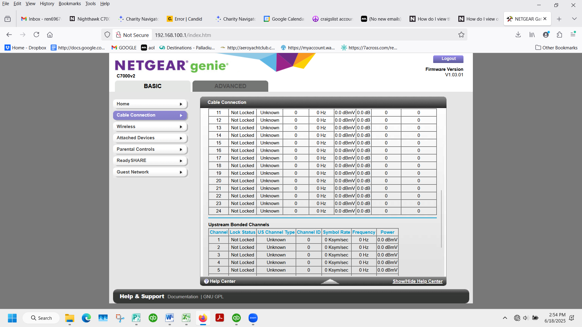

  • Hey Furrye...
     here are the screen shots of the units logs/ and the connection.. also put in the version connection etc..
    let me know what you see that could be causing this issue..
    thanks

      Can you get a top portion of the channels on the downlink channels 1 thru 20 on the cable connections page?
      Any Criticals, Errors or Warnings seen in the event logs needs to be reviewed and resolved by the ISP. Indicates a signal issue on the ISP line up to the modem.
    • FURRYe38's avatar
      Looks like there is no signal on the modem side. There should be some signal on the first range of channels. Nothing is locked in.
      I recommend getting the ISP to send a tech to have a look at this.
