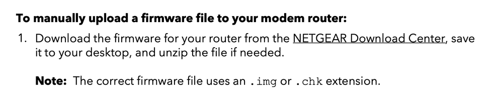

- trainwrekAspirant
Hi,
When I unzip the file, i see a .bin file (CAX30-V1.4.11.2.bin). But when I look at CAX30 manual, it mentions that the firmware file should be either a .img or .chk file. Just want to make sure that .bin file is the one that you upload via web UI to get the firmware version to 1.4
Thanks
- That is correct. I used the .bin file that was a part of the zip package
