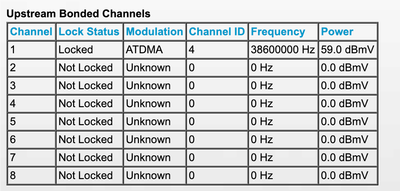

I am having solid amber upstream light in my modem Netgear C6300 and i believe because of that i am getting rediculosly slow speed for my internet. I am attaching my log detail here. any help would be appriciated. Also i am using Comcast as my ISP and called them many times but they are saying its modem problem.

Same for me, I did factory reset, shut this off..
still nothing..signal look like this

Spilette wrote:Same for me, I did factory reset, shut this off..
- plemansGuru - Experienced User
Your upstream power is way to high. It'd definitely cause issues.
Any splitters, amplifiers, or signal attenuators inline? If so, remove them. check the line all the way back to the box. They've been known to stick signal attenuators in the box.
