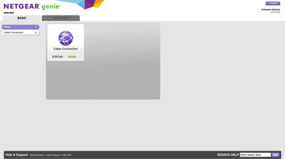

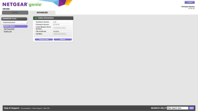

Cable Modem Details
Netgear CM1000

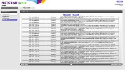

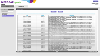

Logs (after rebooting the cable modem)
Note that the logs are captured across two images
Here are the logs in text format.
2024-12-20, 20:48:43 Critical (3)  UCD invalid or channel unusable;  CM-MAC=;CMTS-MAC=00:90:f0:5c:0a:00;CM-QOS=1.1;CM-VER=3.1
2024-12-20, 20:48:42 Notice (6)  DS profile assignment change. DS Chan ID: 33; Previous Profile: ; New Profile: 1 2 3 .; CM-MAC=;CMTS-MAC=00:90:f0:5c:0a:00;CM-QOS=1.1;CM-VER=3.1
2024-12-20, 20:48:41 Notice (6)  DS profile assignment change. DS Chan ID: 32; Previous Profile: ; New Profile: 1 2 3 .;  CM-MAC=;CMTS-MAC=00:90:f0:5c:0a:00;CM-QOS=1.1;CM-VER=3.1
Time Not Established Notice (6)  Honoring MDD; IP provisioning mode = IPv6
Time Not Established Critical (3)  UCD invalid or channel unusable;  CM-MAC=;CMTS-MAC=00:90:f0:5c:0a:00;CM-QOS=1.1;CM-VER=3.1
Time Not Established Critical (3)  SYNC Timing Synchronization failure - Failed to acquire QAM/QPSK symbol timing; CM-MAC=;CMTS-MAC=00:90:f0:5c:0a:00;CM-QOS=1.1;CM-VER=3.1
2024-12-20, 16:57:49 Critical (3)  UCD invalid or channel unusable; CM-MAC=;CMTS-MAC=00:90:f0:5c:0a:00;CM-QOS=1.1;CM-VER=3.1
2024-12-20, 16:56:19 Critical (3)  UCD invalid or channel unusable; CM-MAC=;CMTS-MAC=00:90:f0:5c:0a:00;CM-QOS=1.1;CM-VER=3.1
2024-12-20, 16:49:56 Critical (3)  UCD invalid or channel unusable; CM-MAC=;CMTS-MAC=00:90:f0:5c:0a:00;CM-QOS=1.1;CM-VER=3.1
2024-12-20, 16:49:55 Critical (3)  No Ranging Response received - T3 time-out; CM-MAC=;CMTS-MAC=00:90:f0:5c:0a:00;CM-QOS=1.1;CM-VER=3.1
2024-12-20, 16:49:52 Critical (3)  UCD invalid or channel unusable; CM-MAC=;CMTS-MAC=00:90:f0:5c:0a:00;CM-QOS=1.1;CM-VER=3.1
2024-12-20, 15:52:02 Critical (3)  UCD invalid or channel unusable;  CM-MAC=;CMTS-MAC=00:90:f0:5c:0a:00;CM-QOS=1.1;CM-VER=3.1
2024-12-20, 15:50:57 Critical (3)  Resetting the cable modem due to docsDevResetNow
2024-12-20, 15:31:06 Critical (3)  UCD invalid or channel unusable; CM-MAC=;CMTS-MAC=00:90:f0:5c:0a:00;CM-QOS=1.1;CM-VER=3.1
2024-12-20 15-30-01 Critical (3)  Resetting the cable modem due to docsdevResetNow
2024-12-20, 12:57:14 Critical (3)  UCD invalid or channel unusable;  CM-MAC=;CMTS-MAC=00:90:f0:5c:0a:00;CM-QOS=1.1;CM-VER=3.1
2024-12-19, 12:23:27 Critical (3)  UCD invalid or channel unusable; CM-MAC=;CMTS-MAC=00:90:f0:5c:0a:00;CM-QOS=1.1;CM-VER=3.1
2024-12-19, 12:23:26 Critical (3)  No Ranging Response received - T3 time-out;  CM-MAC=;CMTS-MAC=00:90:f0:5c:0a:00;CM-QOS=1.1;CM-VER=3.1
2024-12-19, 12:23:19 Critical (3)  UCD invalid or channel unusable; CM-MAC=;CMTS-MAC=00:90:f0:5c:0a:00;CM-QOS=1.1;CM-VER=3.1
2024-12-19, 12:23:19 Critical (3)  SYNC Timing Synchronization failure - Loss of Sync; CM-MAC=;CMTS-MAC=00:90:f0:5c:0a:00;CM-QOS=1.1;CM-VER=3.1
2024-12-19, 12:22:56 Critical (3)  UCD invalid or channel unusable;CM-MAC=;CMTS-MAC=00:90:f0:5c:0a:00;CM-QOS=1.1;CM-VER=3.1;
2024-12-19, 12:18:37 Critical (3)  SYNC Timing Synchronization failure - Failed to acquire QAM/QPSK symbol timing; CM-MAC=;CMTS-MAC=00:90:f0:5c:0a:00;CM-QOS=1.1;CM-VER=3.1
2024-12-19, 12:18:32 Critical (3)  Received Response to Broadcast Maintenance Request, But no Unicast Maintenance opportunities received - T4 time out; CM-MAC=;CMTS-MAC=00:90:f0:5c:0a:00;CM-QOS=1.1;CM-VER=3.1
2024-12-19, 12:18:32 Critical (3)  SYNC Timing Synchronization failure - Failed to acquire QAM/QPSK symbol timing; CM-MAC=;CMTS-MAC=00:90:f0:5c:0a:00;CM-QOS=1.1;CM-VER=3.1
2024-12-19, 12:18:31 Critical (3)  Received Response to Broadcast Maintenance Request, But no Unicast Maintenance opportunities received - T4 time out; CM-MAC=;CMTS-MAC=00:90:f0:5c:0a:00;CM-QOS=1.1;CM-VER=3.1
2024-12-19, 12:18:29 Critical (3)  SYNC Timing Synchronization failure - Failed to acquire QAM/QPSK symbol timing;  CM-MAC=;CMTS-MAC=00:90:f0:5c:0a:00;CM-QOS=1.1;CM-VER=3.1
2024-12-19, 12:18:28 Critical (3)  Received Response to Broadcast Maintenance Request, But no Unicast Maintenance opportunities received - T4 time out; CM-MAC=;CMTS-MAC=00:90:f0:5c:0a:00;CM-QOS=1.1;CM-VER=3.1
2024-12-19, 12:18:26 Critical (3)  SYNC Timing Synchronization failure - Failed to acquire QAM/QPSK symbol timing; CM-MAC=;CMTS-MAC=00:90:f0:5c:0a:00;CM-QOS=1.1;CM-VER=3.1

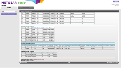

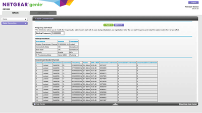

Connection Information
Note that the connection information is captured across two images

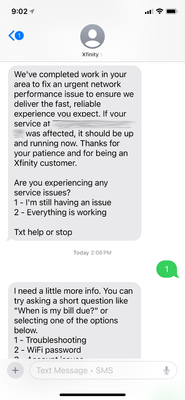

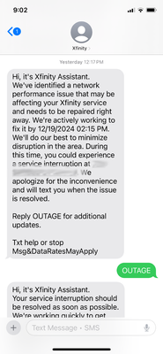

Yesterday I received a text message at 12:17 pm from Xfinity stating that there were performance issues in my area and work was being done to revolves these issues.
Then, at 1:39 pm, I received a text message from Xfinity stating that the work had been completed.

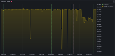

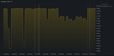

Performance

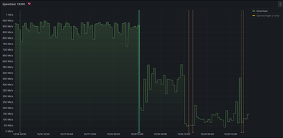

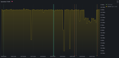

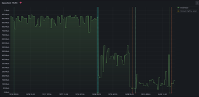

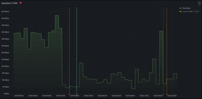

Below are graphs showing results for speed tests using Speedtest.net, executed at the command line periodically to monitor my internet performance.
5 Day Performance
2 Day Performance

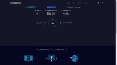

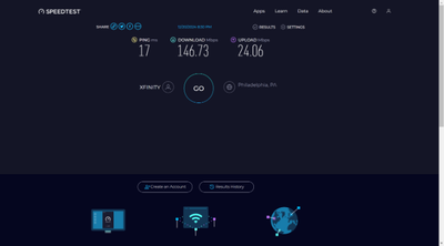

Detailed Speedtest Results
Here are a few Speedtest.net results from the above graphs with details and links.
12/20/2024 at 8:30 PM
https://www.speedtest.net/result/c/aa5d9da2-3027-4bcd-ade3-fdbc65f41b6e
12/20/2024 at 7:29 PM
https://www.speedtest.net/result/c/aa2bace2-7097-43ce-9d26-16dfa89ee45b
12/20/2024 at 6:30 PM
https://www.speedtest.net/result/c/4139107e-643f-47b2-bdff-843dce7250fa

    Cable Modem Details
    Netgear CM1000
    Performance
    5 Day Performance
    2 Day Performance
