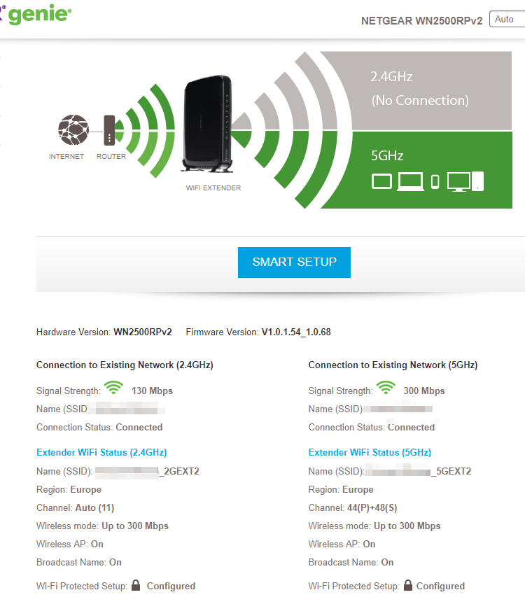

    What does the extender show for the uplink to the router - signal and link speed? Here a similar (slightly older) N300 unit (same image added as attachment):

      Hello. I have updated to the latest firmware version. Here is the genie screenbelow. Iam still having problems connecting to the network, even though getting three bars. Thank you for your response.

        You are showing only the extender network.  Can you also tell us about the extender->router link quality?  Posting the same page as schumaku did would help (using the web browser to reach the extender web ui, not the app).  Also, what color is the router link LED on the extender?
