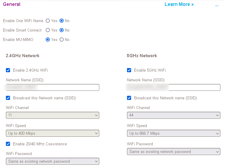

  • 2 things to try based off your pictures that I noticed your using dfs 5ghz for the backhaul and the 2.4ghz backhaul as well
    1. factory reset the extender. Reinstall it using the installation assistant but during the reinstall uncheck the "extend 2.4ghz" box.
    You'll still be able to use the 2.4ghz but it won't use it as failover for if there's issues on the 5hgz.
    2. make sure the backhaul isn't using the dfs channels. It could be that there's a random dfs broadcast in your area and if so, the extender and router are required to switch off those channels for a period of time. you could be getting the drops when it switches back and forth or over the 2.4ghz.

    1. factory reset the extender. During the reinstall, uncheck the "extend 2.4gh" network option. this disables the extender using the 2.4ghz signal as failover for the 5ghz. 2.4ghz is slow and sensitive to interference. If something is causing the 5ghz to drop and the 2.4gh failover is running, it can create issues.

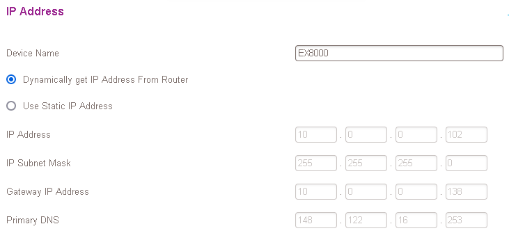

    2. go into the router and set the extender with a static ip address. Maybe for some reason the router's dhcp/ip address lease time is expiring and not renewing.

      After this, I will set the static ip.
      If the static ip do not help, I will do another factory reset and uncheck the "extend 2.4gh" network option.
