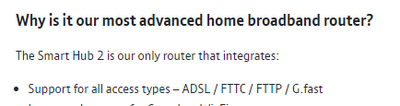

    BTs smarthub2 appears to support several technologies:
    Fiber to the Curb. Fiber to the Premises. g.fast https://en.wikipedia.org/wiki/G.fast  - WOW.
