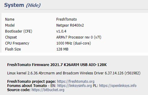

  • My patience has run out. Goodbye Netgear software, hello (after a few years off) FreshTomato software.
    God bless Shibby.
