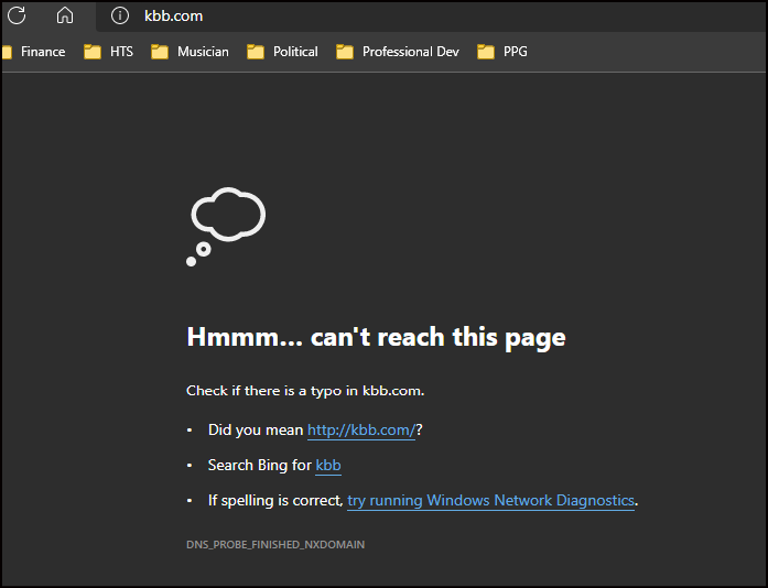

  • Final Solution
    • Rolled back the router firmware from .76 to .68 and everything works perfectly again.  Upgrade to .76 and everything fails again.  Back to .68, everything good again.  One post this chain mentioned that it had been fixed in a beta version but never made the final released version.  Come on Netgear!  Get this solved so I can get back to current firmware.
    • Old version (working) = V1.0.4.68_10.1.75
    • New version (not working) = 1.0.4.76_10.1.82
    Scenario
    I browse to a website, a valid functioning and available website, and I get the "Hmmm…can't reach this page" in MS-Edge browser, similar kind of thing in chrome.  It says "DNS_PROBE_FINISHED_NXDOMAIN".
    Evidence
    • Error Message
    • F12 Browser Dev tools shows no "request" or "response".  Clearly a DNS issue of some sort.
    • The odd thing is that it could be a site I just went to and is theorically cached.
    • Also, I just keep hitting refresh and eventually the URL loads successfully.
    • The refresh workaround is only good on "whole page" situations.  When a page loads and then does client side calls to get REST api data it just fails and I can't make it retry so SPA apps are a real problem.  Oddly, keep trying and eventually it might get through.  F5 refresh, click SPA button to retrieve data #FAIL, F5 refresh, click button again, might work.
    • DNS_PROBE_FINISHED_NXDOMAIN
