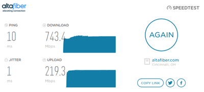

I've seen this issue in other posts and web, but with no resolution.  Scenario: I have R6700v3 router with firmware V1.0.4.122_10.0.95.  I pay for 750mbps and only get 250mbps download max with this router. I tried reinstalling firmware followed by factory reset. Tried removing power to everything and powering everything back up (with time delays) in proper order from modem, router, to computer.  Still no luck.  I know the IP modem (optical fiber - Nokia G-010G-A) is good because I have another older router (Asus RT-N66R) that atually gets 750mbps. Also tried disabling QoS (disabled by default), turn off Access Controls (disabled by default), turn off Traffic Meter (disabled by default). I am at a loss. Very frustrated with this router now. Loved it, now hate it.  Not noticable in my last house because IP speeds were 200mpbs.  New house is 750mbps and now I see the limitation.  Fully hardwired setup. I've turned off all other devices and still no go with the R6700v3 router. What is interesting, is if it is set as an Access Point it actually gets the 750mbps! But when it is in router mode it does not.  I downgraded firmware to V1.0.2.66_10.0.48 and it now gets to around 550mbps - not what it should be and now living with security vulnerabilities.
Any other ideas out there?

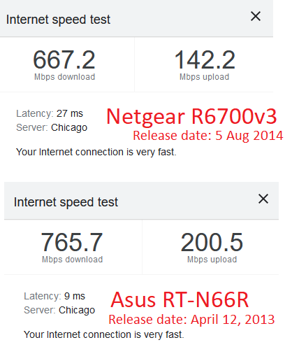

      I have a Gigabit fiber connection and with any new firmware past 1.03.66, my max speed test is around 180mbit. The firmware update after that which integrated the Armor software kills/throttles LAN wired speeds. Instead of giving us an option for a new firmware version without the Armor code, they are forcing it on us and don't seem to care that they're slowing down people's connections. It amazes me that with technology and Internet speed continuing to trend upward that they seem to think this is acceptable. People reported since 2019 that the Armor code severely limited download speeds but they won't offer a fix. I've pretty much given up hope at this point and will probably buy a router from a different brand. It amazes me that I'm still reading this years later and they are oblivious to their customer's needs. Word of mouth and reputation goes a long way, you need to do better Netgear or you're going to keep losing customers. The tech who installed my fiber was shocked when I downgraded my firmware and showed him the difference in speed.
      Netgear needs to offer a firmware that's secure and modern without the Armor code that decimates wired throughout.
