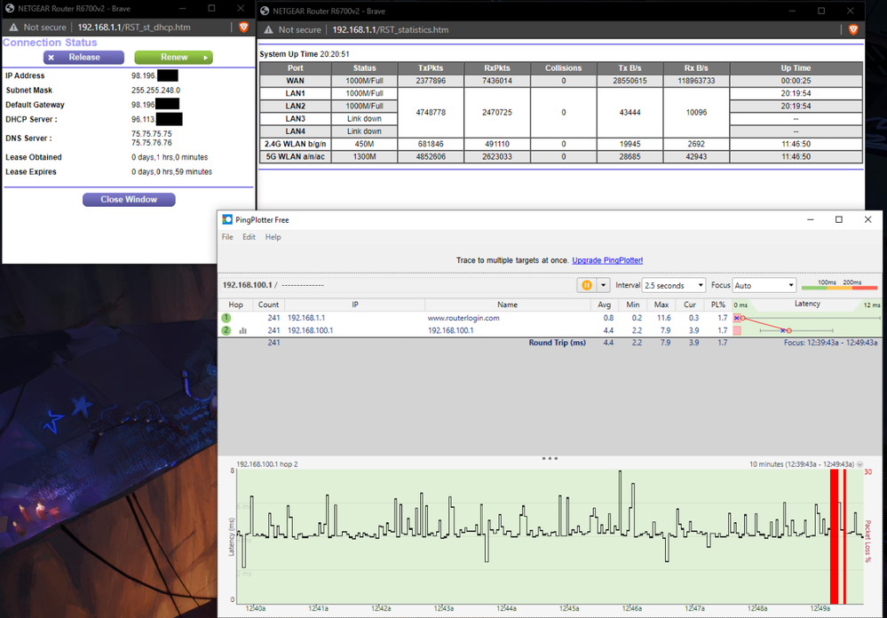

R6700 Disconnecting periodically.
Logs below.
Modem is SB8200, Router is R6700v2. Disconnects seem to not happen when wired in to the modem directly. Already power cycled, downgraded the firmware (and updated the firmware) and factory reset the router.
In the R6700v2 settings, I can check the connection status. Lease Obtained sits at 1 hour or 2 hours for the most part. DHCP refreshes half way through, so the when it renews every 30 minutes or 1 hour, it disconnects. I cannot change the lease time in the R6700 settings nor in the SB8200 settings. I attempted to assign my computer an IP so it wouldn't have to deal with DHCP, but I either did it wrong or it didn't work and still disconnects me. Ipconfig /all shows my lease expiring in 24 hours.
The disconnects aren't a crazy big problem, but sometimes they can be long enough to where I get disconnected from games. As you can see in the logs, it's 1 second, but that one second for the router turns into about 3-4 seconds for me.
I've tired everything that I think I could do to resolve the issue outside of buying a new router and seeing if it still happens.

  • Esch wrote:
    Hitting the exact same issue. Same configuraiton, modem, router.
    Any additional suggestions?
    Sadly, no. I tried everything I could think of outside of buying a new router.
    Recently, it was fixed. Lease Obtained on the modem settings is now set to 4 days and when it renews it doesn't drop internet. I didn't do anything to change this, so I can only assume it was on Xfinity's side and they finally fixed it.

  • FURRYe38's avatar
    Doea the Internet LED on the reouter change color when this happens?
    Ensure the LAN cable between the modem and router is of good quality. CAT6 is recommended.
    After you factory reset the router and setup from scratch, have you powered OFF the ISP modem for 1 minute then back ON?
    • Wahe's avatar
      Wahe
      Tutor
      LED changes to solid amber
      Used CAT6, CAT5e (came with the router)
      Powered off both, same result.
  • Update: Factory reset, updated the firmware to V1.2.0.88_1.0.1. Still happening.
    Disconnected the R6700v2, connected another old router (Linksys E1000). Did not disconnect. I was the only one on the network when I was using the E1000. Going to try and test a similar thing tonight, going to disable the wifi and make my PC the only thing on the network.
