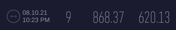

  • I have a Nighthawk R6700v3 with the latest firmware (v1.0.4.120) installed and recently noticed that I was having the same speed issue. It turns out that I had turned on Traffic Meter in the app a couple days ago.  Turning it off immediately increased download speeds from 200Mbs to 700Mbs without rebooting.
