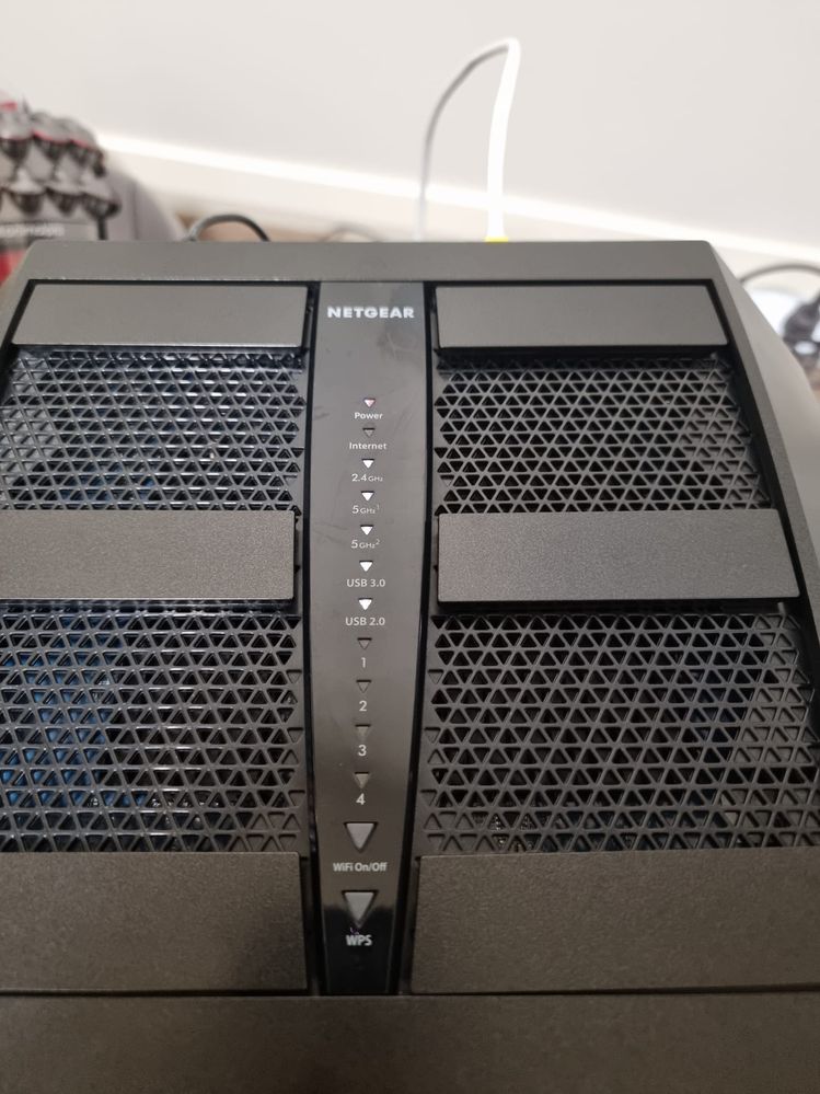

R8000 bricked
I have attempted tftp & nmrpflash numerous times but there were never any "flashing light" moment.. is the router certified gone? Thanks..

    What are the lights on it doing? (all of them, color, blinking, etc)
    what error are you getting when you tried tftp/nmrpflash?
    Did you try a different power supply? (I've seen the wrong ones used and cause issues or ones going bad)
    • mui's avatar
      mui
      Power: solid half red & half white
      2.4ghz, 5ghz1, 5ghz2, USB3.0, USB2.0: solid white
      and the rest are not on at all..
      tftp had #0 block, and doesn't seem to be loading anything at all
      nmrpflash had Error: Ethernet cable is unplugged, i have tried different cables but still the same..
      I will try to find a different adaptor to try and let you know.
