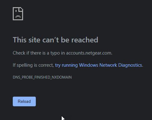

        I'm not the type to pile on but Bob is right. I had not issues, but upgraded to the newest firmware for my R8000P as it stated it fixed security issues. and now I get this message from my browser all the time. this is from this forum went I wanted to reply to this post. I have struggled to check if the issue was with browsers, my security, etc. but all comes back to this firmware update.
