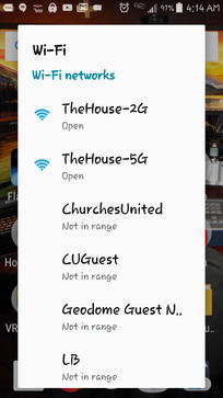

R9000 WiFi On/Off button OPENS WiFi to the Public, HUGE Security Flaw!
Nighthawk X10 R9000 Router Firmware Version V1.0.3.6
WiFi is configured to use WPA2 Security.
Pushing the WiFi On/Off button for 3 seconds turns of the Button LED, and the Antenna LED's, and Shows WiFi OFF in the RouterConfig
WiFi Button OFF Shows WiFi Turned OFF
!!!HOWEVER!!! The Router still broadcasts with WiFi turned off, it just broadcasts without the Security Key and is OPEN TO THE PUBLIC.
My network is exposed, and I would like to turn the router on only when it is needed to reduce WiFi radio exposure to myself sitting right next to the router, and to my kids who sleep directly above it.
The Moment I realized the WiFi Off Button just removes security and opens my home network to the Public!
WiFi Button off, Devices connected and Bandwidth activity showing

      James, there had ben a few similar reports on this issue before. On my R9000 running 1.0.3.10 (and intermediate builds after .6) I have not seen this (random) behaviour anymore.

    • Johnny54321's avatar
      Johnny54321
      That update solved it!
      Now, it all works just fine.
      To recap, I have WPA2 Security on my WiFi Broadcast, and now, when I push the WiFi button on the router, it turns the WiFi On/Off, where as with the previous update, pressing the button would turn On/Off the WPA2 Security and be wide open to the Public.
      Thank You!
