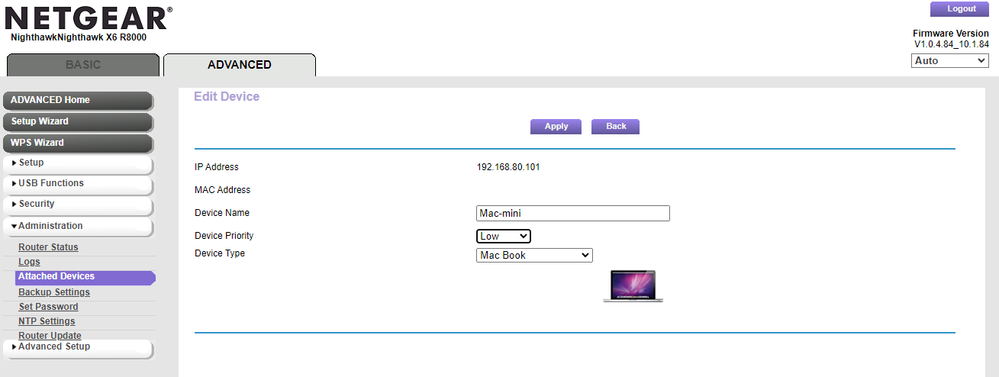

I have confirmed that in V1.0.4.84, when editing any attached device (under Administration) to change its priority, after clicking on Apply, the web interface freezes up and the router must be power cycled.

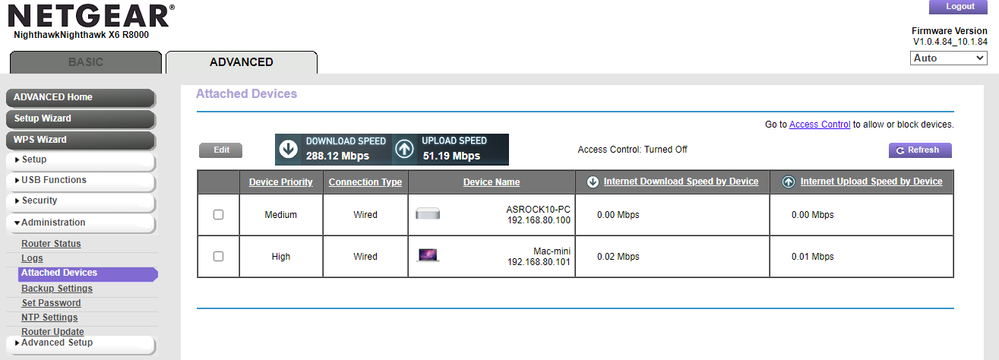

  • Ok so after enabling QoS,
    I now see the Edit and same screen view on Attached Devices:
    Selected Low priority and hit apply and got same hang on the browser:
    Seems to crash the web page ui services. I still have internet access thru the router. I can ping the routers LAN IP address as well. Power cycling the router regains access to the routers web page.
