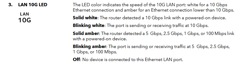

LAN 10G LED is red but internet seems to be working fine.
Cable is good. Any suggestions about why LED is red? I have a Nighthawk RS700  BE 19000 wifi 7 Router, firmware V1.0.9.16_2.0.106.
Should I just ignore the red LED?

    Any chance the LED could be Amber?
    What device is connected to this port?

      Yes, I think I was wrong. The light is amber, which likely indicates my Xfinity 1 Gbps plan is working correctly. It's connected to my Xfinity modem.

    FWIW, I often find that Amber LEDs look Red in some lighting conditions.
    Like CrimpOn​, I am thinking that the device connected to this port doesn't support 10G. If so, that is not a problem, just an expected status.
