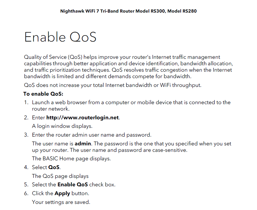

Does the RS300 have a QoS feature?
According to the manual for the RS300 I have access to there should be a QoS feature in the router.
This is a screenshot of the manual, page 104.

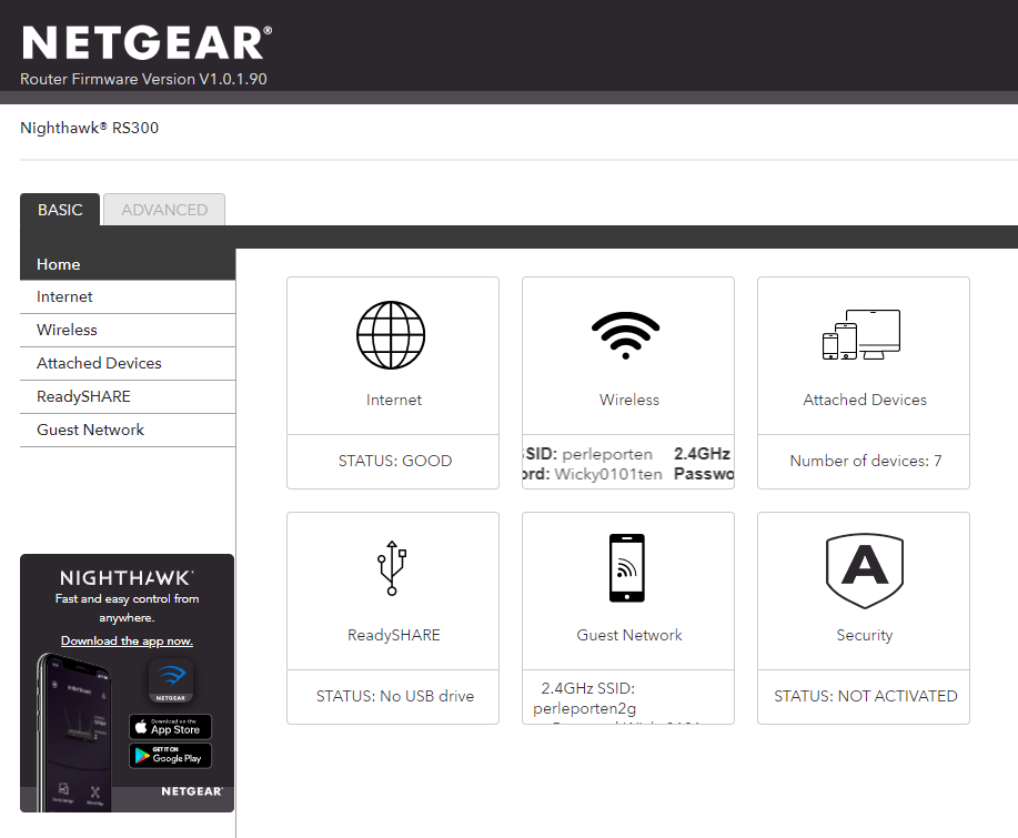

I the admin interface I don't see any references to this QoS menu:
What am I missing her?
The router is bought in Europe/Norway, in case there is some regional differences to the RS300. And in case you wonder, the FW is the latest version I have access to (see details above).
    Odd, that is not the manual I am seeing here:
    That page in the version I see is in the uPNP section, and there is no reference to QOS

      I now see that the manual I found was from May 2024, so that explains the difference. Maybe at some point QoS was a feature, and they removed it from the FW.
      My question was whether the RS300 have a QoS feature or not, and now I know for a fact that it doesn't.

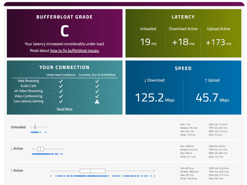

      This is the situation I want to mitigate:
      This is from a computer connected to my RS300 via an extender (EAX15/AX1800), and the latency under load makes video meeting lagging.

        Hard to say whether the buffer bloat is in the router or whether it is in the extender (or the backhaul link between them).   But I think it's unlikely to be the router.
        Is it possible to run this test on a device directly connected to the router? (as plemans​ also suggested).  That would help isolate the problem.

    If you're running through a wireless extender, it will add latency and buffer bloat. The tribands with the dedicated backhauls tend to be lower and also when you hardwire in the extender.
    Compare the pc directly connected to the router versus going router--->extender---->computer.
    Extenders are great but they do add latency.
    You can try using fastlane mode which can reduce latency but at the cost of speed as you end up using the slower 2.4ghz for either backhaul or fronthaul.
