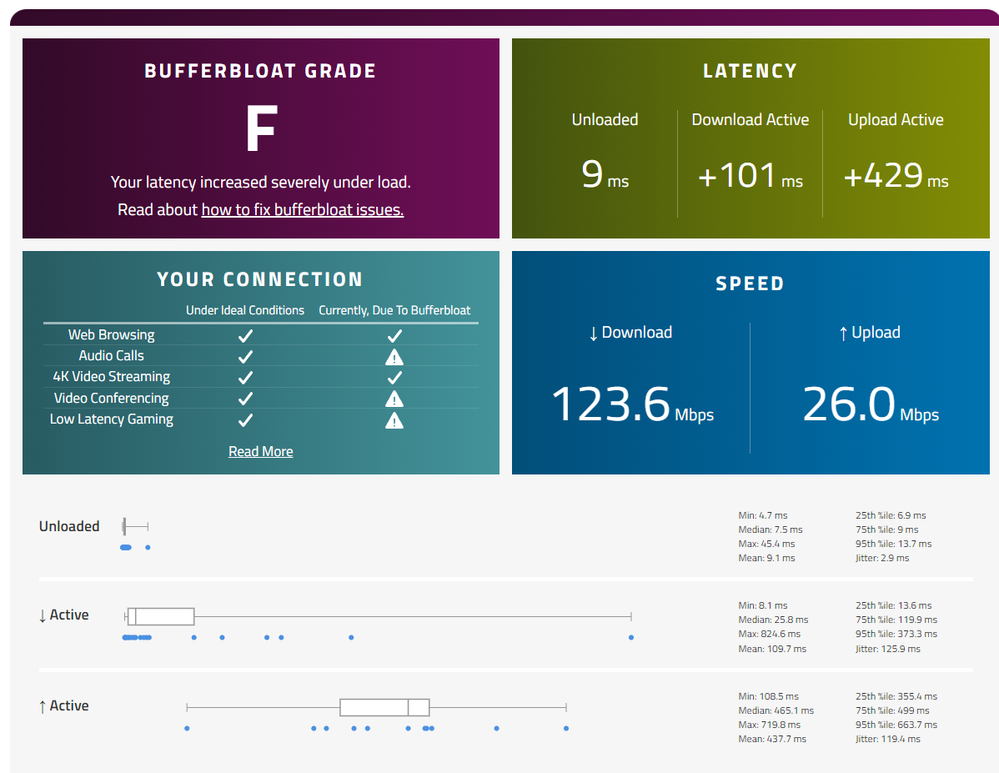

      This is the situation I want to mitigate:
      This is from a computer connected to my RS300 via an extender (EAX15/AX1800), and the latency under load makes video meeting lagging.
        Hard to say whether the buffer bloat is in the router or whether it is in the extender (or the backhaul link between them).   But I think it's unlikely to be the router.
        Is it possible to run this test on a device directly connected to the router? (as plemans​ also suggested).  That would help isolate the problem.
