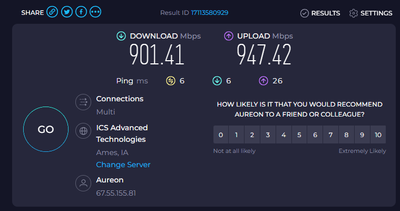

Summary of the situation:
  • Upgrading from RAX80 (AX6000) to RS500 (BE12000)
  • Gigabit Fiber at home 1gig up down symmetrical.
  • Before the upgrade I'm getting 900/900 easily on ethernet
  • After upgrade I'm getting 500/23 on ethernet
  • I still have both routers and I can easily reproduce the issue by switching back and forth.
  • Turned off Armor just in case, but it didn't help.
  • Internal speed test built into router produces the same terrible upload speed results
Before
After
