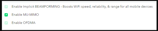

    • JohnNadeau's avatar
      JohnNadeau
      Apprentice
      What happened to Beamforming ?
      Beamforming Option at the bottom of Advanced > Advanced Settings > Wireless Settings:
      It  was v1.0.7.82:
      But I'm not seeing it in v1.0.7.96_2.0.96:
      Did Netgear eliminate the option, or move it to a different menu?
      • FURRYe38's avatar
        Possible was removed and is all automatic with the FW system.
