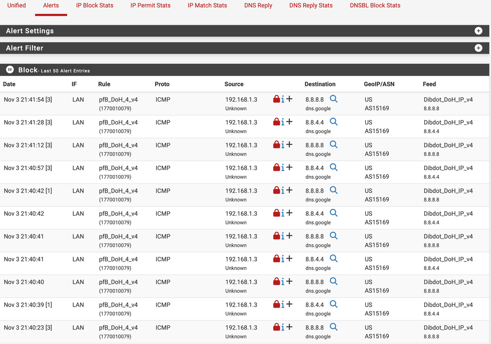

RS700 pinging Google DND every 4-5 secs on AP Mode
I am currently using my RS700S in AP mode behind a pfSense firewall. I noticed the router is pinging 8.8.8.8 and 8.8.4.4 every 4-5 secs showing up in block alerts, more of nuisance than anything with it flooding the logs rather than any connectivity. I assume it's trying to check for an internet connection, but there needs to be a way to block/stop the RS700S when in AP mode. I assume this is not just the RS700 but other models probably doing the same as a lot of them share similar core firmware.
    Actually it looks like one of the clients (192.168.1.3) is doing the pings.
    So maybe look more closely at that client.  What client is it?

  • That IP 192.168.1.3 address is the RS700 itself, yes static, it is not a client. Clients are set to different IPs. Happens even with no clients connected to it so it's pretty confirmatory. Pretty sure it's trying to check for connectivity hence that many ICMP pings to Google DNS servers.
  • As to the other question pings are less frequent with the RS700S set too bypass filtering. DNS for AP mode is set to the firewall (192.168.1.1) which in turn points to Quad 9.
