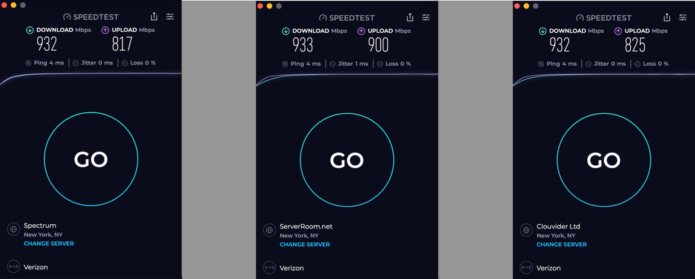

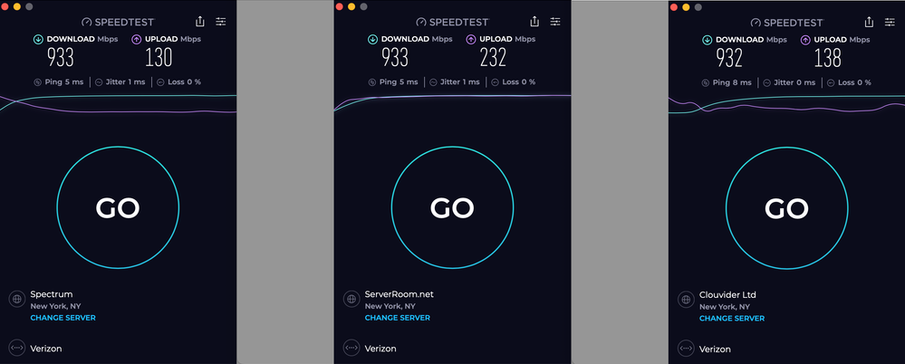

  • BH_C here are some more tests:
    MacBook hardwired to RS700 which is hardwired to Verizon's ONT (used a USB-C to LAN adapter as MacBooks don't have LAN ports)
    ...and just a few seconds later that same MacBook os now hardwired directly yo Verizon's ONT (so RS700 is removed from the chain); same test servers:

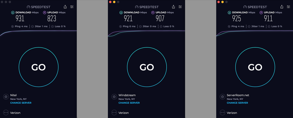

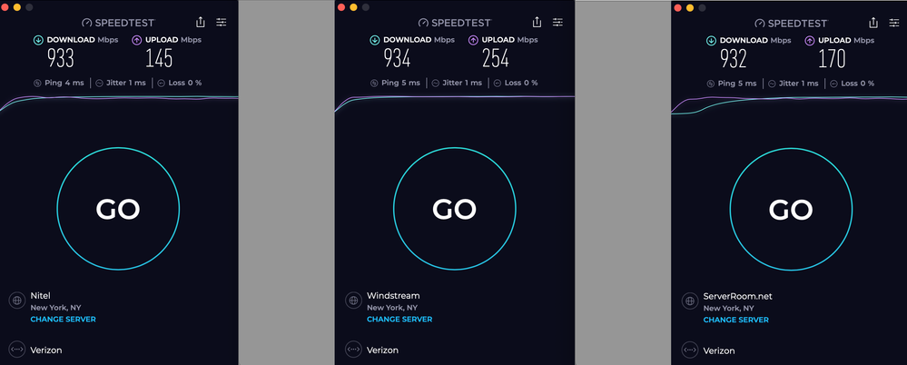

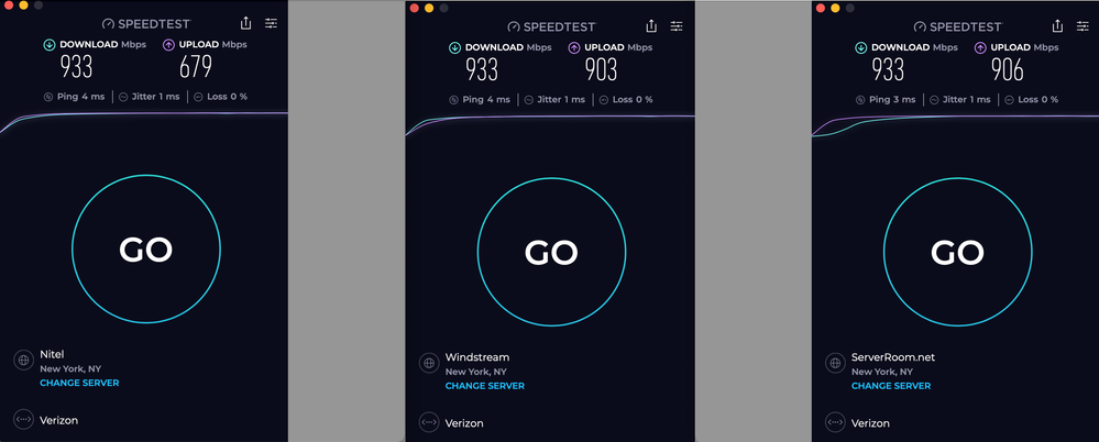

        Hey BH_C more testing this morning, with some interesting results:
        SETUP A: MacBook hardwired to RS700 which is hardwired to Verizon's ONT:
        SETUP B: MacBook hardwired to Verizon's ONT (removed RS700 in between):
        SETUP C: MacBook hardwired to MikroTik hEX (router) which is hardwired to Verizon's ONT, RS700 also hardwired to MikroTik hEX; RS700 is an AP Mode and routing is done by MikroTik:
        You can see that removing the RS700 from the equation resolves upload speeds. When RS700 is switched to AP mode, and the MikroTik router is inserted between the ONT and RS700, doing all the routing, then RS700 can finally max out its own upload test. With this setup, all uploads from hardwired clients max out; however uploads via wifi are still very slow.

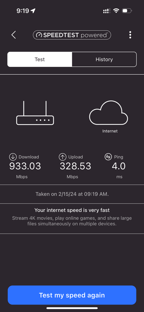

  • Added Samsung Galaxy S24 Plus to the mix: 900+ Mbps down, no more than 200 Mbps up to any WAN test on WiFi 6e.

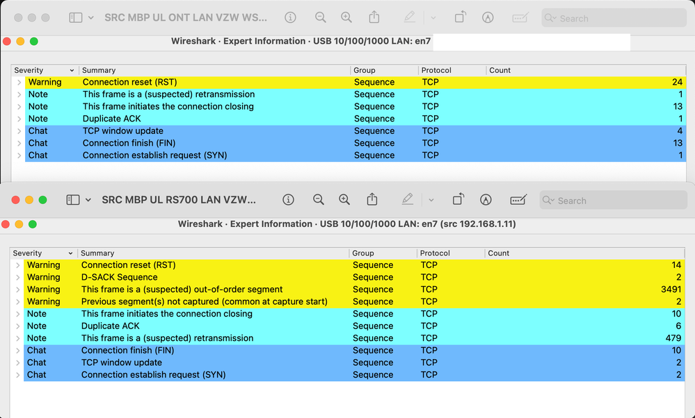

  • Hi again BH_C did a WireShark run this morning on Verizon SpeedTest and capturing src client on upload only for two different setups (about 550K packages per capture). I did the test / capture multiple times with very similar results:
    Setup A: MBP direct to ONT (ethernet)
    Setup B: MBP to RS700 (ethernet) to ONT (ethernet)
    You will notice that when we have Setup A (without the RS700), the WireShark log shows only 24 Warnings and just a few Notes / Chats.
    However, with the addition of RS700 in Setup B, the WireShark log shows a sizable new entry of 3,491 out-of-order-segment frames, plus 479 retransmissions.
    Here are the screenshots:
