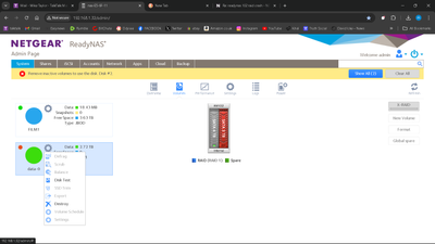

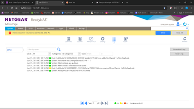

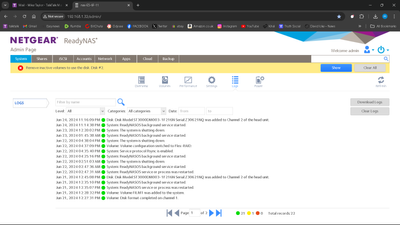

On reboot I can see both drives, the new drive is accessible, the second with the date on is seen but not accessible, i can see the volume of data but cannot open the drive.
Can you download the log file zip from the logs page?
Also post a screenshot of what you are seeing on the volume page.

- birty1Jun 24, 2024Aspirant
the original set-up was x-raid, i did attempt to change it to flex, the damaged drive has limited options when highlighted
