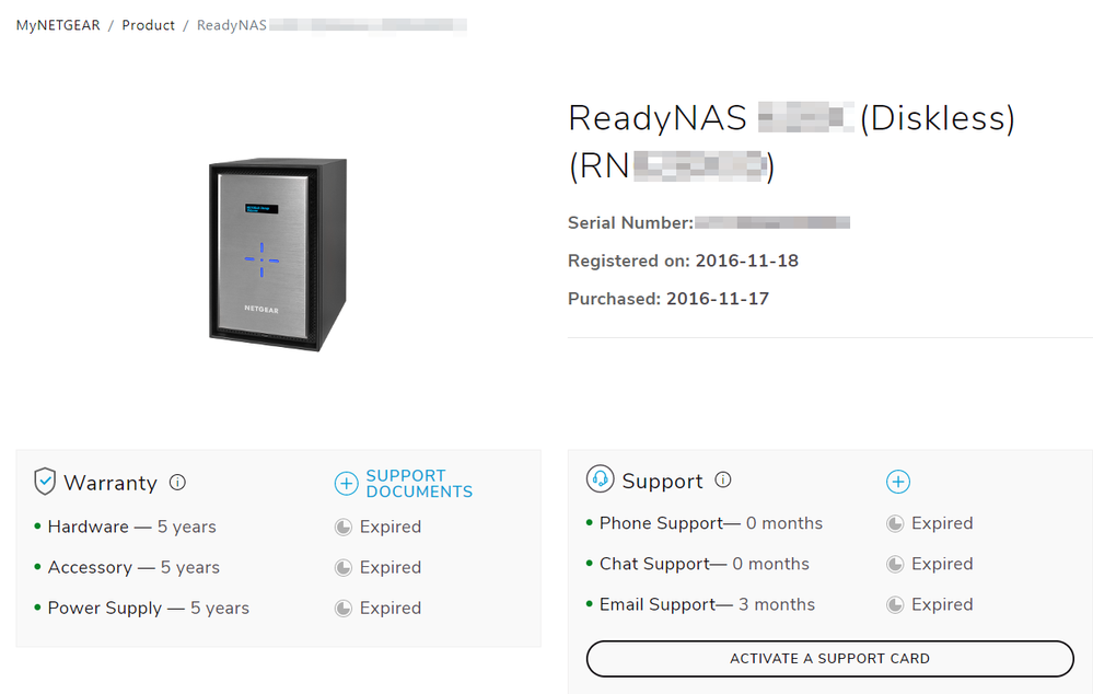

      The first point every Netgear customers is always the https://my.Netgear.com/ portal.
      The warranty status is perfectly visible here.
