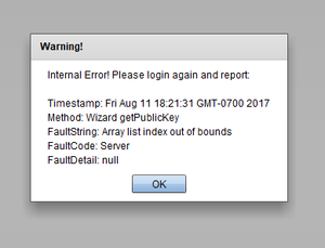

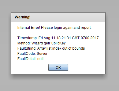

ReadyNAS Photos II not working (again) with OS6 6.8.0
Worked with 6.7.0 and v 2.0.6 but not with 6.8.0 and after upgrading to Photos II v 2.0.7. When accessing locally, going through the Wizard after initial install this is what I get when trying to cr...

Well, I took some time to dig into this tonight... and was able to fix it.
Here's what the logs said:
Aug 23 22:32:49 ReadyNAS1 apache2[27516]: [error] [client 192.168.1.176] client denied by server configuration: /apps/photos2/favicon.ico, referer: http://192.168.1.100:8086/photos2/login.html
Aug 23 22:32:56 ReadyNAS1 apache2[24751]: [error] [client 192.168.1.176] cannot open(/etc/frontview/apache/apache2.pem), referer: http://192.168.1.100:8086/photos2/login.html
So I started investigating here:
root@ReadyNAS1:/etc/frontview/apache# ls -lart
total 68
-rw-r--r-- 1 admin admin 963 May 10 15:21 ssl.conf
-rw-r--r-- 1 admin admin 298 May 10 15:21 READYDROP.conf
-rw-r--r-- 1 admin admin 2539 May 10 15:21 lan-try.conf
-rw-r--r-- 1 admin admin 3045 May 10 15:21 fv-admin.conf
-rw-r--r-- 1 admin admin 279 May 10 15:21 defaults.conf
-rw-r--r-- 1 admin admin 303 May 10 15:21 Auth.conf
-rw-r--r-- 1 admin admin 86 May 10 15:21 Admin_Auth.conf
-rw-r--r-- 1 admin admin 0 May 10 19:19 Ports.conf
-rw-r--r-- 1 admin admin 315 May 22 19:10 ssleay.cnf.in
-rw-r--r-- 1 admin admin 1023 Jun 26 19:10 safe-mode.conf
-rw-r--r-- 1 root root 343 Aug 10 19:52 ssleay.cnf
-rw------- 1 root root 3222 Aug 10 19:52 apache2.pem
-rw-r--r-- 1 admin admin 5241 Aug 19 15:57 apps-https.conf
-rw-r--r-- 1 admin admin 54 Aug 19 16:37 http-share-redirect.conf
-rw-r--r-- 1 admin admin 143 Aug 19 16:37 http-redirect.conf
-rw-r--r-- 1 admin admin 3058 Aug 19 16:37 Shares.conf
-rw-r--r-- 1 admin admin 411 Aug 19 16:37 WebShare.conf
drwxr-xr-x 1 admin admin 446 Aug 19 16:37 .
drwxr-xr-x 1 admin admin 624 Aug 19 16:37 ..
I then ran:
root@ReadyNAS1:/etc/frontview/apache# chown admin:admin *
Then verified the change:
total 68
-rw-r--r-- 1 admin admin 343 Aug 10 19:52 ssleay.cnf
-rw------- 1 admin admin 3222 Aug 10 19:52 apache2.pem
Ownership is successfully changed to admin.
I then shut down Photos II, removed it... then reinstalled Photos II v2.0.7 from the "Available Apps" section. Completed the install... and went through the wizard again, AND... creating the Admin user was finally successful!!
Seems like this may be firmware related or something? I'm not sure what set these to root to begin with but it definitely fixed my issue that I was seeing in the screenshots above while trying to create admin user in the Wizard.
