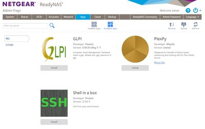

ReadyNAS OS 6.9.3 fail (again)
I just updated from OS 6.9.2 to the latest OS 6.9.3 and found the NAS lost most of the Apps in the store (only 3 available apps in the store now?).

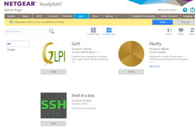

I still have my pre-installed apps listed, however when I try to install one of the new 3 appa, it appears to complete but does not list as installed (shell in a box works, but still listed as un-installed).

    • Retired_Member's avatar
      Retired_Member
      I can upload apps from https://apps.readynas.com/pages/ but the admin page still only lists 3 apps to install from (I installed Shell in a Box from this page, but the WebGUI/Admin Page didn't recognize the install, yet I can URL to it fine):
      ReadyNAS OS 6.9.3 Listed Apps
      Shouldn't I be seeing more apps?
      StephenB - I only listed the folder to show the varied permissions via shell (su to root shows the same folders+ permissions). The Web Admin page i beleive still requires admin login (can't login as root via WebGUI page)?
        Retired_Member
        Shell in a Box installed, NAS re-started ok, but still shows Shell in a Box as un-installed (Shell in a Box works though via direct URL). This is the same for all 3 apps listed.
