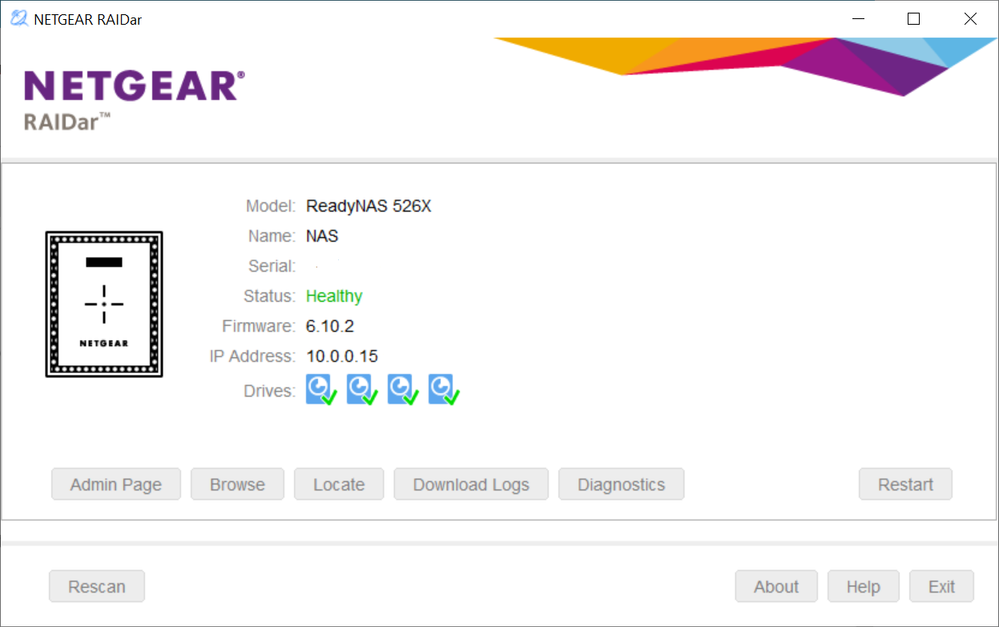

        JohnCM_S  II dont see any option to get logs from raidar, all i see is icon to get to the admin page , browse, rescan, about, help and exit .
        Raidar version 6.5.0
        That sounds like RAIDar 4.3.8 to me.  You should see this:
