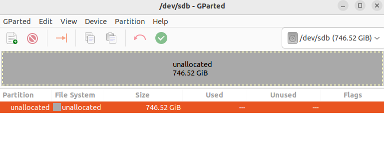

Connecting the drive to my Ubuntu 22.04 laptop with SATA to UAT connectors, it appears the WD30EZRX 3TB drive is only reporting as 746.5 GiB. I tried Western Digital disk tools on it from a Windows machine, but they won't recognize the drive. Windows Disk Manager sees the drive and partitions, but I didn't go any further with it from there.
GParted show this and the only menu option is to delete it.

  • gl01824 wrote:
    I had tried using gdisk commands on the first of the two drives using the old SATA connector and I think I messed it up. Even with the new connector, is shows one large unallocated partition.
    Yes, it looks like you accidentally repartitioned that.
    gl01824 wrote:
    I did install mdadm and btrfs, and have read a little on them, but didn't want to move forward without posting here first. I'm hoping I can mount /dev/sdb3 and copy everything off to another a 4TB USB drive,
    Start by creating a mount point for the volume
    cd //
    mkdir data
    Then assemble the RAID group and mount it
    mdadm --assemble /dev/md127 /dev/sdb3
    mount /dev/md127 /data

      • StephenB's avatar
        StephenB
        gl01824 wrote:
        Yes, I tried both together in the nas, and each individually. I've tried connecting to each with the USB connection, and both output the same (I believe).
        Thanks for responding!
        I am wondering if the SATA->USB adapter is old - some don't support disks > 2 TB.
