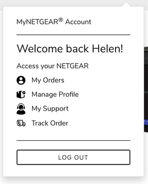

Moved house - can't connect to Readycloud
I have a RN10400 Readynas RAID. We've moved house, and I'm trying set it up - but it's been offline since July. Now I try setting it up again, I discover that when I log in to my Netgear account, I'm...
- Jan 04, 2024
Hellohelenhere wrote:
I have a RN10400 Readynas RAID. We've moved house, and I'm trying set it up - but it's been offline since July. Now I try setting it up again, I discover that when I log in to my Netgear account, I'm unable to access anything via Readycloud.
ReadyCloud was shut down by Netgear around the time you took your NAS offline.
So you will need to find alternatives.
Access to the NAS while you are at home doesn't require ReadyCloud, you can simply log into the admin web ui directly (https://nas-ip-address/admin) and with Windows File Explorer and Finder (MacOS).
Can you explain your other uses of ReadyCloud? Did you use it for remote access? Or for sharing files with family/friends?
