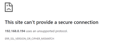

Netgear Readynas Pro 6 - issues accessing admin page & shares
Having issue accessing ReadyNas 6 Pro admin page.... getting....
For that, tried temp disabling fw, ad blockers, etc; Clearing browser cache and try different browsers - Chrome, IE, Firebox  ===
All to no avail....
Also unable to access 2 of 3 shares via Windows explorer ..says invalid username/password.
Tried resetting via an OS/Firmware reinstall from  the boot menu...  shares still not accessible...same invalid username/password message.
RAIDar says status is healthy and all drives healthy; Chassis is populated with 6 drives.  FW is 4.2.31
Don't know what happened..didn't have any of these issues a few days ago...
Some kind of update get pushed?
Any way to fix any of this?   Reset accounts outside of the admin page?

    The issue is because browsers have begun dropping support for TLS 1.0 - which is what your Pro uses.
    But IE should work - you'd get a different warning about the certificate but you can click through that one (unlike the protocol mismatch error in your screenshot).  Installing an old version of FireFox will also work - I tested 94.0.2 myself but there are likely some newer versions that would also work.  You do need to make sure you immediately disable automatic updates after you install.
    Once you regain access to Frontview, you have two longer-term options.  One is to install an add-on from rnxtras.com ( https://github.com/rdynsxtrs/rn4bin/blob/main/apache2/x86/Apache2_2.2.34-x86-0.2.0.bin ).  The other is to convert your NAS to run OS 6 firmware.
    There's a lot more information on this issue here: https://community.netgear.com/t5/New-ReadyNAS-Users-General/Workaround-for-ERR-SSL-VERSION-OR-CIPHER-MISMATCH-problem-for/m-p/2198243  Though that thread is getting a bit long.
