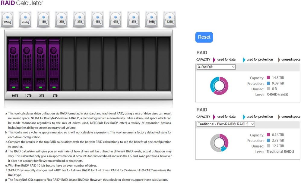

I used the RAID calculator, added 2x 10TB and 2X 3TB. Calculator says total cap then is
Capacity:14.5 TiB
Protection:9.09 TiB
Unused:0 B
Level:X-RAID (raid5)
But after factory reset i end up with 8.17TB
Anyone have a solution to this :) ?

    8.17 tiB is what you could expect using Flex-RAID Raid 5

      I use X-Raid and get 8.17 but calculator says i should get(It's still resync, but capacity will not change after resync? Did factory reset first):
